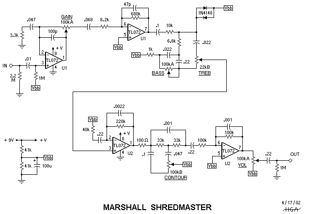

:)  OK, now take a look at this http://www.diystompboxes.com/pedals/schems/Marshred.GIF
and see how easy to "pan" beetwen "two" different tone stacks... a "low-pass-filter" versus "the mid-scooped-filter".
Just add that 100K pot named "contour" and connect the wiper of this pot the ground :)
Try a 50K pot also, I think I like 50K better...
It's very powerful, nice...
