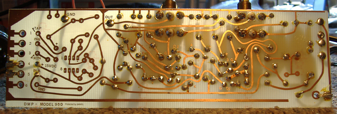

Thanks to the great generosity of Mr. John Della-Vecchia, moderator of the Yahoo "Rhodes-Tech" forum, I was able to put my hands on an original DMP900 preamp board and reverse the values from it ... although there is more work to be done measuring bias conditions and simulating the transfer in Spice I'm posting what I have for now so we can get the ball rolling ... below is a copy of the schematic John Hines sent me a while back of his reversed clone - I added values in RED indicating DMP900 values as they deviate from his schematic ...
when I get a chance I'll get back with some analysis results and ideas on what we can do with all this stuff ... for now pls consider the info incomplete and unverified - I'm still double checking things when I got time ... got a backlog of old amps to revive at work, I'm putting on a Zappa video nite this weekend, and my latest Vibe using a new wide-range constant-amplitude sine LFO I've been developing just came to life yesterday ... yeh!

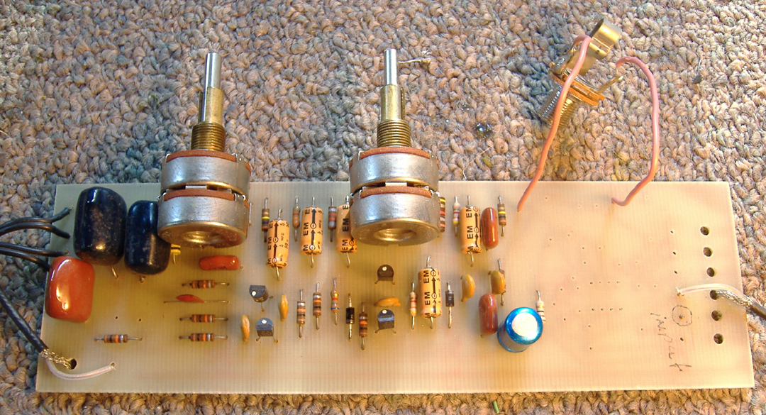

Hi there.  My schematic is the one above being compared to the an original DMP circuit.  Originally I had some problems with the unit I copied the schematic from, and suspected a dud component of some sort, probably one of the FETs.  I've just finished building a clone with identical values, and it works fine so obviously the problems I was having were hardware based. Has anyone else had experience with a unit they've actually constructed and Rhodes-tested?  I'd be interested to compare notes on the effect the preamp has on the sound of different Rhodes'.

I've built a unit into an outboard box with four seperate pots.  I'll rebuild one into my Rhodes to replace the faulty one in there.  I find that with the 'overtone' up full, you can hear the percussive attack of the tines a little bit too much, particularly in the bass.  This manifests itself as a 'dinging' noise on the attack of the note.  I can eliminate this in the middle and high registers by pickup adjustment, but the the lower registers it doesn't seem possible to do this.  Overall though, it sounds great.  I got the J310s from Mouser.  I'm in Australia so the postage cost more than the transistors, but it was worth it.

I know this is a very old thread, but just though I'd let you know that I built the German's guy version (hand drawn circuit in this thread) using the PCB found by EB7+9 (slightly modified) and it works great! I installed it on my brother's Rhodes and we immediately noticed a much more powerful and richer sound. The overtone pots really gives more harmonics. You can do everything from a soft mellow sound to a very percussive sound with strong attack. It would take hours to explore all the different sound this baby can generate.
On the technical side... I added a 15V voltage regulator at the beginning of the circuit. Right now it temporarily runs with two batteries, but I should add an external power supply soon. I remove the original volume and passive bass boost knobs and added 2 more pots for a total of 4. I could not find any of those dual concentric pots so I used 4 100K log pots. 100K seems to be a bit to much. Some pots only works up until half way (the sounds stays the same for the 2nd half) so 50K or lower might be better. We cut the RCA cable and added the circuit right after it.
Some pictures.
