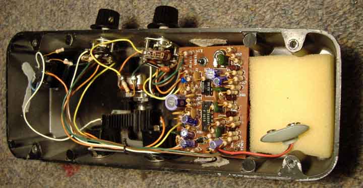

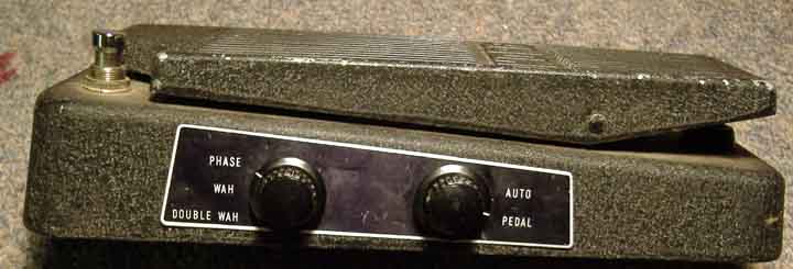

I played this Korg pedal last week - it's a phasor/wah combo that either runs in LFO mode or foot swept ...
It's especially pleasing in foot-mode with both phasor and wah filters engaged (double wah) ...
Wondering if there's a schematic floating around ?? /// If not I'll start reversing it this week and post ...

Wow... I never thought of this kind of switching. I always have the trouble of accidentally switching the wah off when I'm whaling a solo. I really hate the switch under the wah controller. I guess I'll take the switch outta there and attach an extension to the pedal somehow. Thanks for the idea, mate! :)

 "Sticking heavy [multiple] circuitry like PHase Wah into a treadle makes good sense, tricky details must have been worked out on this one...looks like a real nice unit.

I have an extra crybaby wha shell and have been planning to put a phase 45 in it. This sounds like a very interesting idea to combine the phase with the wha. The problem I have been having is deciding how to work the 100K pot, I have a dunlop hotpot, to replace the 500K C speed pot of the phase 45.
This pedal brings up the idea of controlling the sweep rather than the LFO speed. I would be very interested to see this reverse engineered.

... sized @ 300dpi ... if someone can do a B&W of this that would be great ...
Basile
I'm very interested to make a clone about it!
I have only on request: Please could you take photos of the component side, just to see the value of all resistors, capa and ICs. Well if you can also draw on a paper the connection between the footswitch, both rotary switches, the potentiometer and the PCB, that will be very useful to draw a clear schematic and then make a pcb of this  pedal!!

now the most important thing is to make a list all component and their value and their location on the board...
I hope this thing will be very interesting for playing with it... Perhaps a true bypass with a 3PDT and a footswitch for the  "auto/pedal" can be added....

Please Eb7+9 don't let this clone down.....It's almost done! If you can take photos of the component side, we could achieved to make a complet clone... :cry:  :cry:  :cry:  :cry:  :cry:  :cry: ... don't forget us!!!!

thx for the most excellent drawings guys !! - found a minor snag here ...
Eb7+9
MR MULTI - BOARD DRAWING (Top View)
MR MULTI - OFF BOARD WIRING (Side View)
Eb7+9
MR MULTI - ON BOARD SCHEMATIC
MR MULTI - OFF BOARD WIRING SCHEMATIC (Switching Omitted)
Eb7+9
To make easy sense of what the switching does I drew resulting block diagrams for all three modes separately :
PHASOR MODE
WAH MODE
DOUBLE-WAH MODE
I'm sure y'all can see where this is going ... you could wire two other shifter stages and go Triple-WAH and get a nasty-deep swish ...
note: in case you're wondering, the 220k/330k series duo plays no role in the third circuit ... I drew it in just to see where it goes in that setting ...
Eb7+9
I'm pretty sure I got everything right but let me know if you find anything that looks out of place ... I will have the pedal with me for another week or two - fire away any questions you may have regarding the original circuit ...
