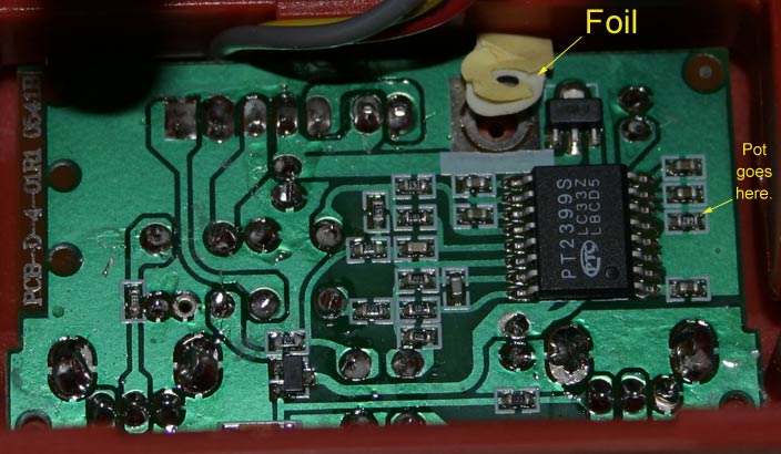

I work at a Guitar Center a we recently got the mini Danelectro Fab pedals in.I was aplynig around with the Fab Echo and liek the sound of it but was annoyed at the lack of a speed control, so i set otu to fix that. After opening the pedal up  i noticed it resembled the Rebote 2 schematic. so i replaced the fixed resistor with a 100 k linear pot and tah-dah my Fab Echo now has a speed control! I picked upthis pedal for 8 bucks with my discount and i had just done a large order from Mouser so i had the pot lying around so i now have a great sounding echo for under 10 bux! these are really great little pedals and can normally be had for about 10-15 bux. with the 100k pot as a speed control you can get anywhere from a quick doubling effect to about a 1 sec . im hoping ill have some sound clips up tomorrow.

it uses a PT2399, and as far as the extra pot well i simpoly superglued it to the side of the pedal until i transfer it into a new box. the bandsaw accident was the result of my cat getting in between my legs wen cutting out the neck for a guitar im building. my left pointer is pretty much healed upnow but it was rather unplesant a couple weeks ago. If anyone here is in the Nashua, New Hampshire area stop into the Guitar Center and ask for Olan (thats me) and Ill give anyone here a discount on the Fab pedals

Since it's all SMD could you give me a general area of where to find the resistor ?

ther are two boards in the fab echothe top boardhas all the switching and power on it, the second lower board has the pots and the IC. if you follow the tracce from pin 6 thers the resistor you need to replace. lug 1 to pin 6 and lugs 2 and 3 to ground.

When you take your Fab pedals apart, be careful how the funky foil patch on the top goes back in, and that it doesn't short something out.  I got a Fab metal on tour and immediately took it apart in the van to see how it worked (nerd :icon_rolleyes:) and when I stuck it back together and powered it up later on the blue LED got bright white and then the Fab was fried.
I think all the Fab pedals have 2 circuit boards, and I'd bet the board attached to the jacks and power supply is universal in all of them (maybe its the same board from the mini Danos) and just handles the electronic switching and power supply filtering, and the board attached to the pots is the actual effect.

Processaurus (or anyone who knows), is there a trick to removing the effect board?  I unscrewed everything, but I'm a little reluctant to start prying.  Here's a pic of the echo board.  I tried to compress it for the dial-up folks.

Good pictures, to get it out, its a little bit of a pry, you pull the knobs off (I had to use pliers, if I remember), and then you have to simultaneously pull up and back (away from the pot shaft "gabled windows"), so the pot shafts don't lever the pot off the board..  The LED seems to have no choice but get bent on its way out.
I think a 16mm pot may be able fit around the "B" in FAB on the top of the pedal, if one measured carefully, because there is an empty spot on top of the PCB there.  You'd have to plan ahead on how you'd get the board back in, though (long wires to the new pot, probably).  Alternately, if it helps, the film caps in front of the middle window (C6 and C2) could get stuck on the SMD side of the PCB, and not hit anything.
After looking at the trouble it would be to do all this, I'd say someone interested in the economics of the situation should spend the extra $10 bucks on the PB&J delay... with mine, I'm probably gonna rob the tiny delay PCB (2 1/4" x 1 3/8") and stick it in another effect, (maybe the EH Polychorus, or a theremin...), maybe keep the FAB enclosure and switching board, and put a small Tim Escobedo-esque circuit in there, or a no knobber...
