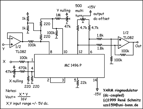

http://www.synthdiy.com/files/2006/ringmod.png
is a fairly clear ringmod, it is for +-15V synth rails, but it would convert to 9v reasonably easily.
It is tragic that a great name like Gonkulator has been wasted on this fundamentally flawed product!
(though, in all fairness, I found it difficult to sleep the other night after I realised - years late - that I could have easily put another knob on my
Blue Ringer so that the local oscillator could be varied from triangle to sine to smoothed square. True, there is nowhere to put the knob... but it still a missed riff. :icon_redface:)

Paul I fixed this thing! Thanks for the pic, by the way.
As a first attempt, I fed pin 8 with a variable voltage (a trimpot) for setting the nulling off-set, but the improvement was minimal. I suspect that the whole bias resistor network of the Gilbert cell is a bit quirky.
Designing the whole section from start was the only solution. I took both your pic and my BlueBoob ringmod as reference.
Now it's usable. The carrier is still faintly present but it's way better than the previous design.
By watching the output on the scope, I notice that the waveform not really symmetric (both sine wave as carrier and modulator), and some distortion is present. I don't know if this is due to bad biasing or insufficient power supply (is 9Vdc enough for the 1496?); anyway, the same asymmetry was already present and more noticeable on the original design...
In the schematic you posted there's an extra "output dc-offset" control. Is it necessary since the output will be coupled by a capacitor on our GonkMod?

Don't worry about the DC offset control, I think that's just for the diy-synth crowd.
I think 9v is just about enough for the 1496, but firstly it isn't going to be running at its best, and secondly, 9v doesn't mean a FLAT 9v battery :icon_sad:
Also when something like this is stuffed in a box (or just prototyped) it can be difficult to decide whether the bleedthrough is coming from imperfect multiplying in the chip, or if it is leakage via capacitive coupling or common power supply rail or what.
Unfortunately the fact that the ear can hear over a range of a million to one or so, means that if you don't want to hear something, it has to be DAMMNED quiet.
I find with the AD633, which really is just at heart a 1496 core with improvements of all kinds, that when the carrier is tuned out as best as possible, what is left looks like a harmonic. Certainly it is not a perfect sine.Once you get to that, you can't do much better.
Incidentally the AD633 has slightly better bleedthrough charaxteristics on one pair of inputs compared to the oteh, I don't know whether the 1496 is like this. Likely so!
