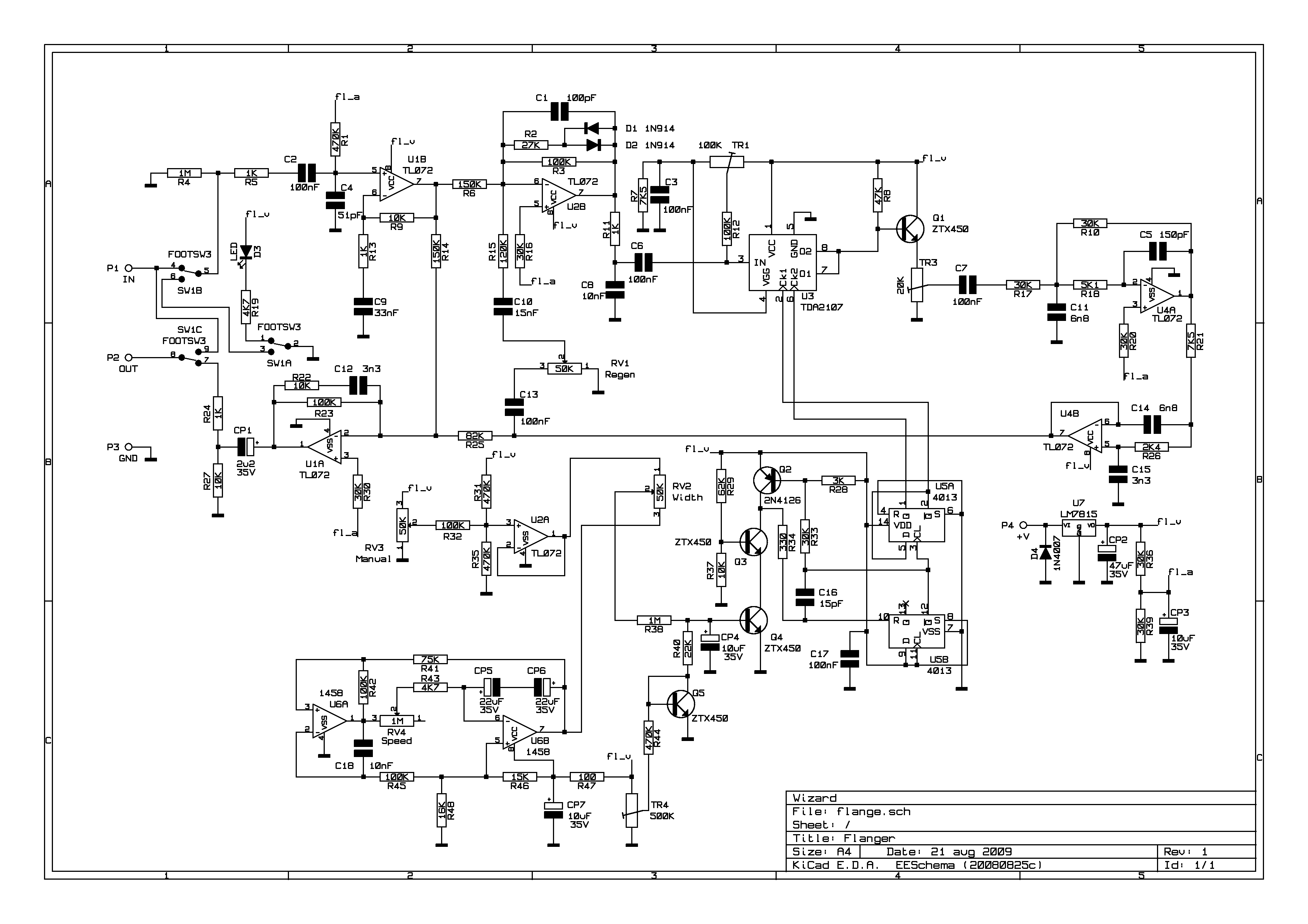

Fender3D
I just build this MXR from shreadaholic modded to accept MN3007 (I used TDA2107).
This is the schematic or pdf www.wizardinside.it\foto\schemi\flange.pdf
Not really sure about the min clock freq to use I set it at 54MHz ' cause I like it that way  :icon_razz:

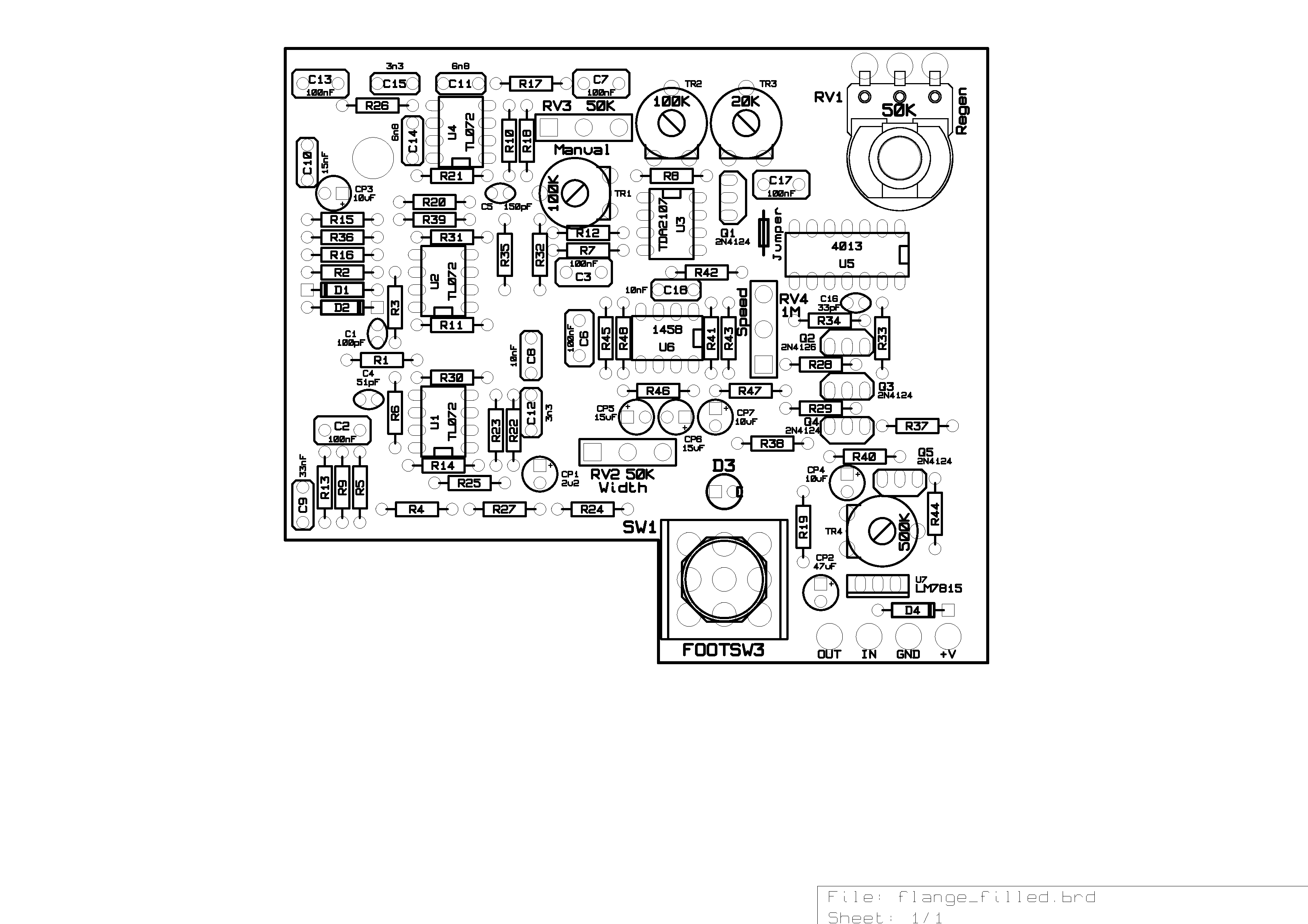

Layout:
or pdf www.wizardinside.it\foto\schemi\flange_brd.pdf
edd29
Quote from: Fender3D on September 19, 2009, 01:17:40 PM
Layout:
the link is not working or can't found.

Fender3D
Thomeeque
#17
Quote from: Fender3D on September 19, 2009, 07:01:33 PM
Quote from: edd29 on September 19, 2009, 03:26:20 PM
...the link is not working or can't found.
fixed
Some browsers (e.g. my Firefox) may still have problems with a format of the links (backslashes, no protocol). This works for me:
http://www.wizardinside.it/foto/schemi/flange.pdf
http://www.wizardinside.it/foto/schemi/flange_brd.pdf
T.
