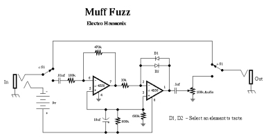

I started going through some flawed early builds to try to correct them. I built this to spec and it does get a decent Muff sound:
...except that I get a fizzle/sizzle as each note decays [both chords and single note]. The strings seem to be a bit more sensitive than I'd expect...similar to when you use
a transistor that's too high gain.
I can almost always remove annoying wails and screeches in common 2-3 transistor fuzzes with strategically placed caps, but I'm not sure where to start on this one (I rarely use opamps)....or is it simply the nature of the 4558. Is there a quieter alternative...

You could try placing small caps across pins 6 and 7 as well as pins 1 and 2 of the opamp. Start with 100pf caps maybe.

I would replace opamps with CD4049/69 inverters. The schematic will look similar. Run Off Groove has a lot of inverter circuits. You can safely replace opamps with inverters if the non-inverting input of the opamp is connected to half the supply voltage. The inverter input will be the inverting opamp input. The biggest difference is that opamps have much more gain.
You can try a bunch of things to make the opamp less fizzy. The mere fact that changing opamps has an influence on how these circuits sound proves to me that  opamps are not working as they should. Traditionally the idea is that opamps have so much gain that differences between units are made as small as possible. I made a fizzless tubescreamer with inverters (UBE Screamer from ROG). IMHO it sounds so much better.
So try inverters, the difference is huge.

Try putting something like a 1Meg resistor in parallel with the clipping diodes.
LucifersTrip
Quote from: Chugs on November 21, 2010, 05:28:19 AM
Just got done trying that...no luck using as high as .001uf
thanx for the suggestion

#6
Quote from: slacker on November 21, 2010, 04:24:18 PM
I just tried that. 1Meg didn't work so I slowly lowered the resistance. The sizzle actually  disappears when I got down to 1.85K
The downside is there's a little fuzz gone and there is some added hiss/hum (the type that my kitchen light causes in some of my other pedals)....though, not bad at all. I think I'll try some caps to remove the hiss/hum.

tubelectron
Hi LucifersTrip,
I am surprised that the treble taming caps didn't remove the fizzy decay. But it is often a sign of auto-oscillation, so tame the gain a bit (220-470K // to diodes), insert a higher serial resistor than 10K for IC2, try a 1n cap from 1 to gnd... Or may be it's a coupling by wiring ? It sometimes arises... You should make it work at the end !
Personnally, I prefered the transistor version, in a modified way, as follow. No hum, no hiss, no fizz, certainly less gain, overdrive-styled but good-sounding if you play quite loud...

LucifersTrip
Quote from: tubelectron on November 22, 2010, 04:30:44 PM
Hi LucifersTrip,
I actually have a 100k pot there. Raising the resistance did nothing to stop the fizz.
...just tried..unfortunately no change.
It seems that a small resistor parallel to the diodes is the best solution so far. I tried it again & this time the fizz disappeared at 3.75K
instead of the 1.85K before.  It adds a little hum/buzz, which I'm working on removing now.

j_flanders
Quote from: LucifersTrip on November 21, 2010, 03:16:53 AM
You get (or rather got, back in 2010) that decay because the schematic is missing a resistor in the NFB of second opamp, parallel to the clipping diodes.
The schematic was probably drawn (and also copied thereafter) from an old ehx Muff fuzz that was missing some components. The complete ones I've seen, do have a resistor there.
There are two threads where I posted a lot of photos with gutshots of complete opamp muff fuzzes.
The "problem" really stems from the absence of a feedback resistor in stage 2.  Bear in mind that, in the absence of any other negative feedback, stage 2 is "persuaded" to shoot for the open-loop gain of the chip, until the diodes begin conducting, at which point it behaves more or less like a Tube Screamer...for a moment.  The fizz you are hearing is really the impact of ripple in the signal, that falls above and below the conduction threshold of the diodes at an audio frequency.
Look at Pinkjimiphoton's thread today (and Jack Orman's responses) for an example of how the same general circuit should be done.  The Muff Fuzz circuit, as drawn, has a gain of 5x in the first stage, Jimi/Jack's introduces more gain in the first stage, that brings the signal up closer to the forward voltage of the diodes in the second stage, and also includes a feedback cap to remove some of the artifacts of crossing the conduction threshold back and forth.  It's a better version of essentially the same circuit.
I've made/modded several of the discrete transistor versions, including a modded clone of the Double Muff.  I think it is a better-sounding circuit, and quite amenable to many useful tone-shaping mods.  Stock, it is essentially a fixed-gain silicon Fuzz Face.
