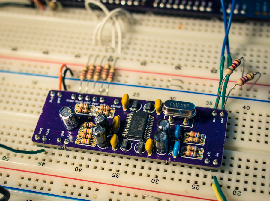

I'm making a wet/dry/wet rig, and I'm trying to figure out a way to control the level of the wet channels without having to run wires back from the rack to the pedal board.  What I want to do is a  MIDI controlled stereo volume control in the rack that I can control from an expression pedal on the board, and I THINK I've figured out the way to do it, but wanted to run it by others.
I have a couple of Highly Liquid MPA boards, which I'm using for the 8 digital outputs, but they also have three digital pots on each board, but I want to limit the risk of digital noise getting through to the audio signal.  So, can I just use the pots as voltage dividers to drive a couple of opto's set up like the audio path of a Tremulus Lune (i.e., an Opto between two opamp buffers).  Like so (kinda, this is ten minutes, blatantly ripping off the Tremulus Lune schematic - I'm sure that some things would have to be updated, and I might go with an opamp to drive the opto instead of the transistor - either way, I'm not sure if I've got 10k or 100k digital pots, but I know they CAN'T drive an LED):
So, do that twice, and I've got a stereo MIDI controlled volume control, right.  Right?  And for that matter, this is all coming right after an opamp mixer, so do I even have to put in the first buffer, or can I just put it immediately after the mixer?
