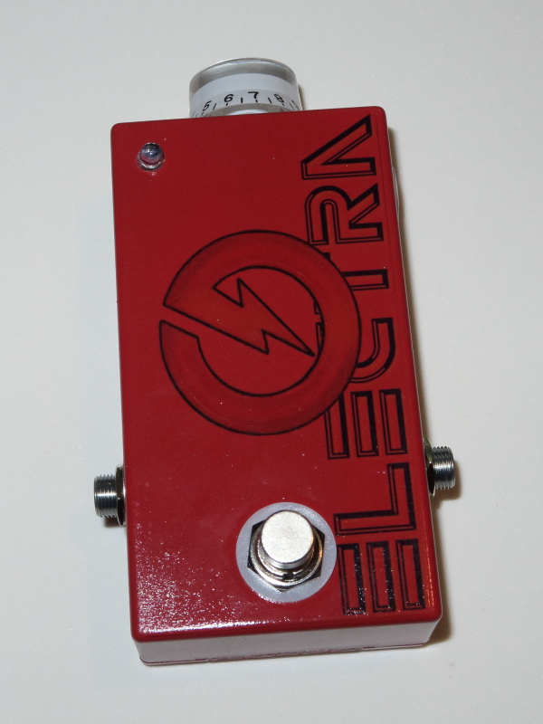

For my first waterslide decal I put a red design on my blue enclosure and it came out black. Even though it looks ok I want color. I use an inkjet and I was wondering if this still happens on laserjet. Also any other advice on which colors to use for waterslides.
tonyharker
The trouble with inkjet inks is that they are transparent. Some colour laser toners are also.  They show best on a white background.
Yeah, this. ^^

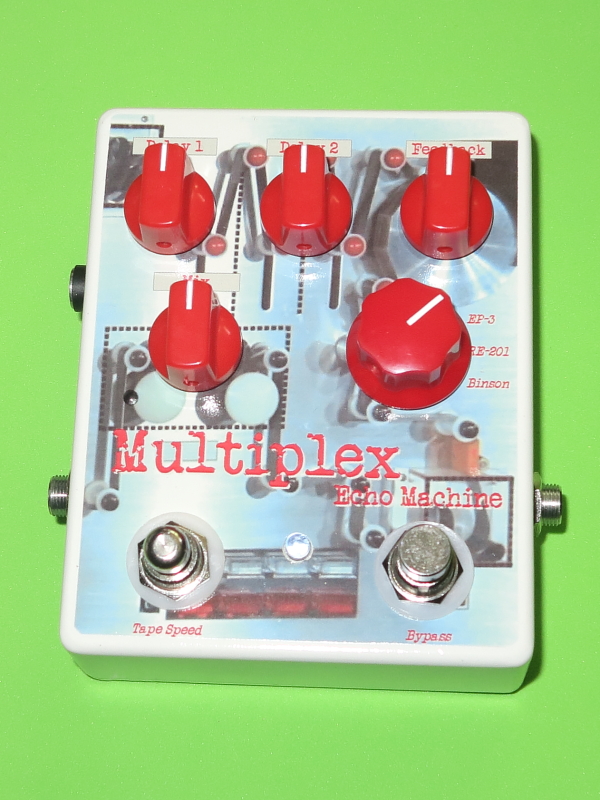

I recently got a colour laser printer and thought my pedals would instantly become a riot of colour.  Not so.  This is one of my first ones:

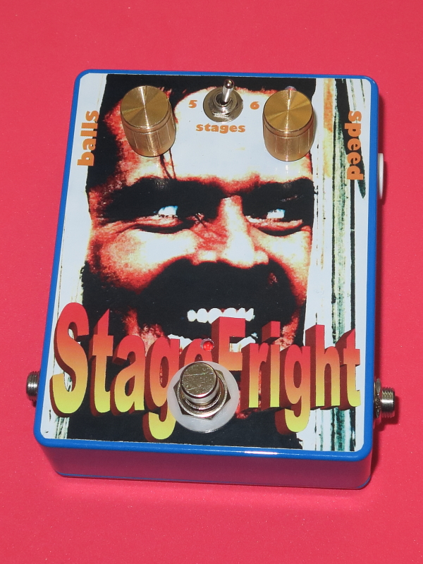

The (clear) decal is colour, though you'd barely know it.  The red enclosure is simply too dark.  So you either need to use white decals on dark enclosures (1), or clear on light-coloured enclosures (2):
1:        2:
