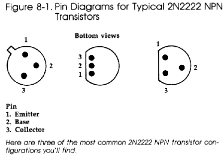

Although the 2SC828 is "just another NPN", it has a different pinout than a great many other similar-gain NPNs, being ECB rather than EBC.  Possible you've used a transistor type that requires twisting the leads around to work with that board?

I googled the pinouts for both... I'm going to google them again.
replaceablehead
Right so 828's have ECB pinout and 2n2222's have EBC pinout.
You know that was actually not that easy to find out. Google images brings up plenty of 828's with regular pinout and some of those specs sheets with the ambiguous top down view, or is it bottom up? I don't know because I can't read Russian.
Anyway, I guess I've fried those transistors. But I'm relieved the mystery has been solved.

Fairly unlikely, BJTs can be pretty robust in this sort of pinout mix-up.

Agreed.  There's actually more risk to the transistor from overheating during unsoldering than there is by being installed the wrong way around.
Carefully unsolder (and fresh, or flux-enhanced, solder wick would be best for that job) the first transistor, slip a piece of insulation you stripped off some wire over the relevant transistor pins, so you can bend them around to conform to the board's pinout without shorting out against each other, and do the same signal tracing you did before.  The odds are good you'll see the signal proceed through more of the circuit.

look for the 3d diagram of the part in question. draw it on all your diagrams, until you know it.
and the thing with the 2d diagrams - if you view the transistor from the top, you can't see the pins. this renders the diagram somewhat useless. you can only see the pins looking onto the pins.

Alright, it's working.
