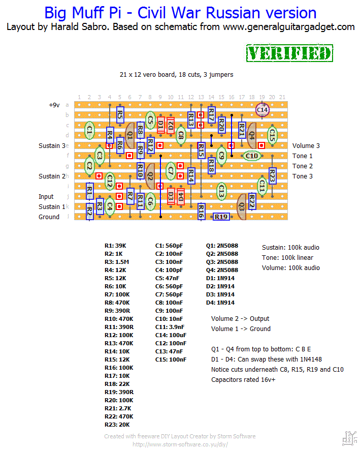

I will try my damnedest to describe what exactly is occurring here. I have built a Civil War Big Muff Pi from Sabrotone's layout.
Here is a layout link: http://www.sabrotone.com/wp-content/uploads/2010/04/Big-Muff-Pi-Civil-War-Russian.gif
And the schematic is based on: http://www.generalguitargadgets.com/pdf/ggg_bmp_grus_sc.pdf
Here are the transistor voltages (Q1-4 as listed on layout; battery at 8.7V):
Q1: E .228 B .85 C 1.4
Q2: E .247 B .87 C 1.04
Q3: E .246 B .87 C 1.04
Q4: E 2.0 B 2.7 C 2.0
I realize that Q4 is an issue. Perhaps it is not the only issue, but it is definitely an issue. I've tried as hard as I could to find any kind of solder bridge, running an x-acto blade through the tracks, looking at it under a magnifying lens. I have yet to find any different in the readings.

the fact that all 4 collectors are so off (should be ~4 to 5v) suggests possibly a more general problem like the transistors aren't oriented properly.
i would first see if you can just get the 1st stage to bias correctly. just look at everything up to c3 on the schematic. it should be separate anyway if you disconnect the sustain pot, so you can easily see if stage 1 is working without any affect from the others

Q4 looks shorted - probably shot (as long as there isn't an extaernal short). R21 2k? EH used many different components and values over the years (basically what they could get their hands on at the time) but combined with a 390k R22 that will seriously throw Q4's bias - R22 and 21 form a devider which sets the bias voltage for Q4's base..
Have you actually tested the transistors? If your DMM has a transistor test, use it. You can use the diode test to verify the transistor's pinout and that it is actually (probably) working. It should look like two diodes, conducting from Base to Emitter and Base to Collector, BE having a slightly larger threshold. Nothing else should conduct.
Check the transistors, then take it stage by stage. Maybe include pictures of your build, to see if there's a layout error. For now, my money is on the transistors though.
It also helps to get it working with a proven schematic (such as the GGG one) first, then change things.
Oh hang on - did you mean R21 on the schematic or the layout - they don't match? I'm looking at the schematic! 2k7 to 2k isn't much of a problem (layout) - 100k to 2k (schematic) is.
*edit*: the transistors need to be tested out of circuit, otherwise the measurement will be thrown by the surrounding resistors.

I meant R21 on the layout. I wish they matched as well - would make this conversation much easier. 2k7 to 2k, not 100k to 2k.
Today's agenda is to work solely on the first stage and then move further. There is certainly a chance that the transistors are shot - I'll double check them - but they are fresh out the bag and swapping Q4 didn't change readings at all. My guess is I screwed something up over component failure.
