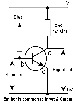

Now would be a good time to use the audio probe to pinpoint where the squealing noise begins in the circuit. That junction would be the first to inspect for errors.
You could also review the transistor's pin voltages. This will draw out obvious issues. Well, obvious to those who understand circuits. Know your transistors pinouts. I also suggest doing the legwork yourself first. GGG has a page for these voltage. Anything that looks suspiciously off would need attention.
http://www.generalguitargadgets.com/pdf/ggg_tb_m2p_instruct.pdf
You can use this template to follow & share if needed.
