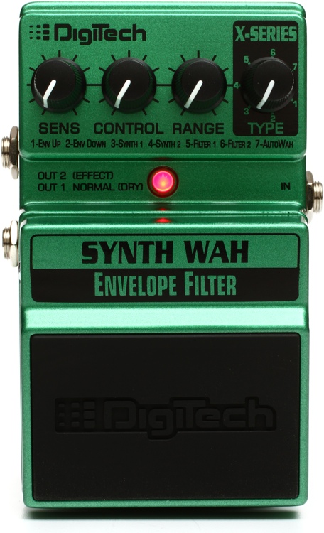

I can get that kind of sound from my Digitech SynthWah
...and I guess it could be done with my Maestro-FSH1 (haven't tried).
When I say I can get that sound from the synthwah I mean it sounds good enough for people to recognize it.
Tone is subjective, YMMV.  ;)
You will notice there appears to be no means to achieve different sweep rates on that pedal.  I'm not saying it's a bad pedal, but it illustrates what I said earlier about different auto-wahs having different "feels"....unless there is some means to adjust attack/decay rates, which the Meatball has but few others do.
Keeb
Quote from: Mark Hammer on September 26, 2011, 04:06:05 PM
You are absolutely right.
However, if you use it for Mysterious Ways live, people are going to recognize it. Kind of a "good enough" scenario.
If you really want a versatile filter/wah pedal I'm sure you could find better.
Furthermore, it's not even DIY.
