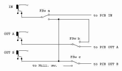

The guitarist in a band I'm in has asked me if I can make him a 4 way ABY switch.  I've made passive ABY's no problem, but four?
What he wants to do is have four guitars plugged into one amp and kick a switch for each guitar.  He's currently using two ABY boxes daisy chained, so he's only actually got three guitars on the go.
Has anyone got passive schematic?
Could I use this http://www.muzique.com/schem/mixer.gif with DPDT stomp switches to ground (+LED so he knows which channels active)??
Any thoughts welcome.
Many thanks
Matt

Latching relays and four momentary switches with some diodes to route the switching logic. Latching relays only need current when changing state and have two coils, one to connect the switch and one to disconnect. You route each switch to turn on one of the relays and turn off all the others.
You'll need power for it to work but the signal will be connected only via mechanical contacts.

In my experience, latching relays are great for saving power, but add significantly to the complexity of the circuit needed. If you have to have power to it, and it's a DC power adapter, not a 9V battery, nonlatching relays are easier to use.
It is easy to implement a "radio button" switching setup with CMOS logic. There is a schematic for an easy one at geofex in the article "A Programmable FX Switching System http://geofex.com/Article_Folders/fxswitchr/fxswitchr.htm, in illustrations 7 and 8. The 74C373 happens to do this in a straightforward way for any number up to eight.
You're probably going to want to read the other articles on relays for audio switching and footswitching systems at Geo as well.

I've read your articles on relay switching at geofex. This is the direction I want to go in and now I need to actually get some 5v relays.
