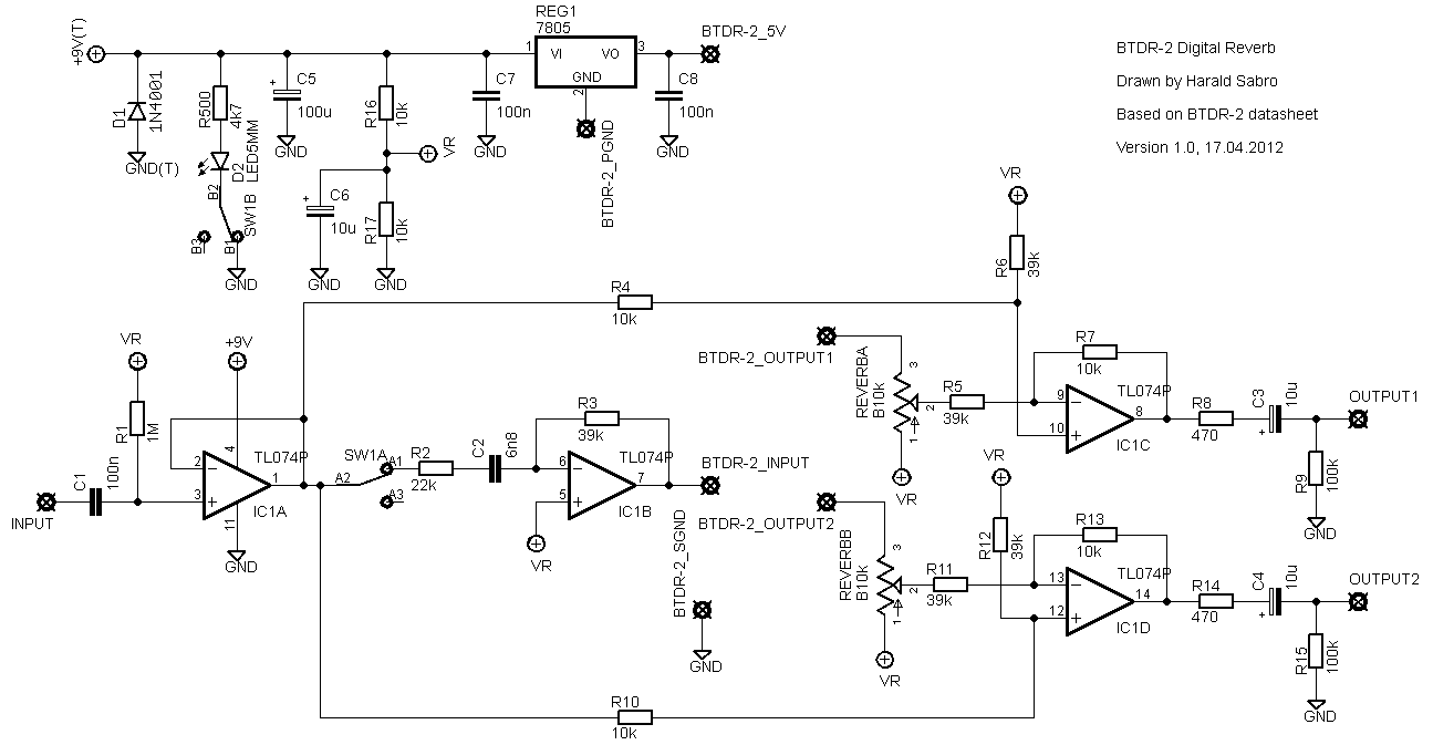

I'm not sure how happy the 4066 is when playing with signals that are swinging around ground. Isn't most of Andrew's 'wicked switches' about biasing up to half supply to prevent popping?
Edit: http://www.diystompboxes.com/smfforum/index.php?topic=74935.0;wap2
There is more out there, but my memory is failing me at the moment.

yep there is still a little pop with reverb vol fully off..
no difference on swapping/changing the resistors.
i was looking at sabrotones reverb by harald..but i bet that pops too..
http://www.sabrotone.com/?attachment_id=2763
samhay
#633
It might, but it's working a little differently - the dry signal is never lifted (it won't do 100% wet) and is high-impedance going into the non-inverting input of the output op-amp.
The bypass arrangement you have came from slacker right? Might be time to see how much joy he has had with it in the real world.
Edit - actually, thinking of slacker. You could try to go back to FET switching and use his FET switch-with-an-RC (http://www.diystompboxes.com/smfforum/index.php?topic=101126.msg939855#msg939855). You can still do the switching with a DPDT this way...
