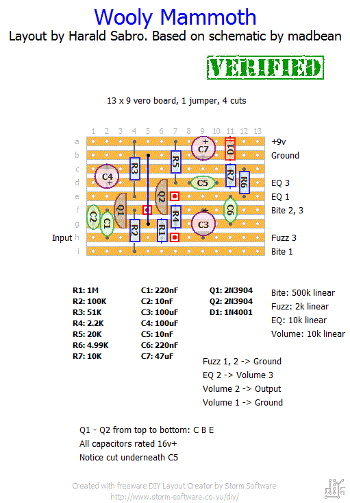

Elijah-Baley
(It was a Box of Rock, not a BSIAB)
My PSU is an old Boss. I think it's ok, I don't have problem, usually. I built more than 40 pedals, I got this problem with some of the last circuits, but I always solved, escept in one case.
I used this layout: http://tagboardeffects.blogspot.com/2013/02/zvex-super-hard-on-compact-layout.html.
Now, as I mentioned, I have to solve this problem with a circuit out of box of a Woolly Mammoth, that was ok initailly, later it starts to squeal, then it stopped, than it start to squeal again. No matter if I use resistors or diode in line ot the 9v, or bigger cap across the ground. I have to work on it again.

Elijah-Baley
Don't worry MrStab. :)
About the layout I used for the SHO, I got what you mean, but I solved the problem, fortunately.
Perhaps I found always goo dlayout, but casually the last I used it was a bit tricky, it wasn't the schematic, the components valus, but right the layout. I don't know.
My last unsolved squealing problem is the Woolly Mammoth, this layout: https://www.sabrotone.com/?attachment_id=1026
I worked on it without problem changing some parts with sockets, and one day it starts to squeal, then it stopped, and then never stopped to squeal. In a few of days. I tried bigger cap, I guess 330uF, in the power root. As well diodes and resistors.
I don't touch it for about two months.
I should to try again. But that was really tricky. I thought to build it again, or at least try it on the breadboard, at least.
