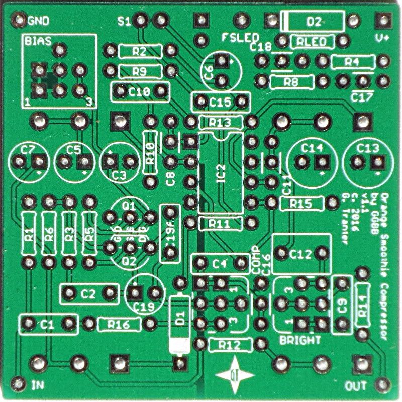

Jon (midwayfair) graciously created an Eagle layout for me but I wanted to make a couple of small changes so I have been sitting on it for-ev-er! I finally got them done tonight, so I'm willing to make it available now via osh park. BUT - it hasn't been tested, and I'm not going to as I simply don't have the time. Also, I still need to generate the gerber which I haven't quite figured out.
Anyway - it is a possibility that this could happen soon (I mean it this time). Are there any others still interested?

Boards are coming!!!
I have ordered a handful of "prototype" boards that should arrive some time in the first half of April (on the slow boat from China). I'm calling this version 1.1 as there are a couple of very minor changes from the original (although they could easily be jumpered out to revert to the original) which I think are improvements.
When they arrive I will post another message here, and I'll also update the build guide. There will probably be enough for everyone based on interest that's been expressed so far, but if you want to reserve a board, send me a PM. Pricing to be determined but definitely very low - probably $5 or less (shipping extra - and I'm in Canada so it might be a little more than US rates).

Boards arrived today and they look good. I'll check one over and get back here about details for payment, shipping etc. Stay tuned!

Apologies for the poor photography.
They look like they turned out pretty good. In comparison to the two commercial pedal boards I've used they aren't as nice but they aren't far off. So in comparison to some of the internet posts I've seen about Chinese prototypes fabs I'm quite happy. The holes are smaller than I expected (maybe the plating?), so some things are a snug fit but nothing needs to be forced. Next time I do a board I will enlarge the hole sizes a step.
