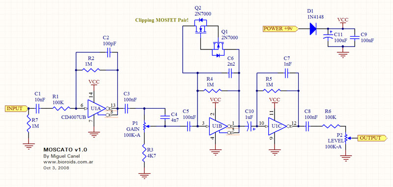

I have built this pedal using Russian schematic, just added output buffer and drive control. Here is Catalinbread SCOD schematic for comparison, too, cause they're similar.
And even one more, Moscato:
Looking at those two other schematics, it seems that Russain 2p2 bypass caps are too small. I will try with 2n2 soon.

Do you mean to imply that you tried with 2p2 caps already? Where did you get such small caps? What kind of caps were they? Ceramic?

2p2 caps? Maybe by the Gimmick capacitor method...
http://213.114.131.21/begin/gimmik-0.htm
...however, I fear the cut-off will be super low with 2n2 against a 2M2 resistor. 22p might work well to smooth any harshness.
Believe it or not, I bought 2p2 caps and used them for a build  8)
However, SCOD use 2n2, 10n and 22n bypass caps; Moscato use 100p, 1n and 2n2. I will try with 2n2 to see what's going on.
