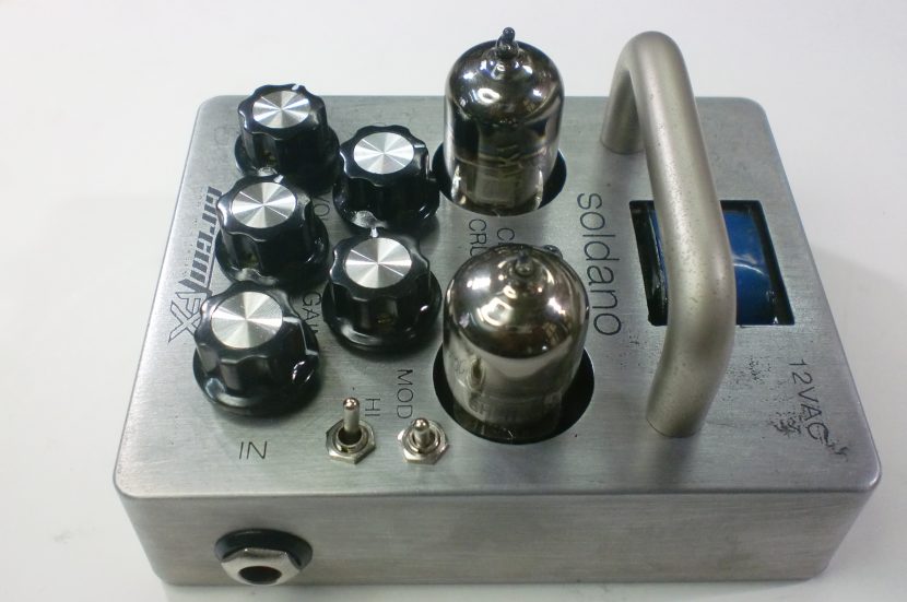

My first plan is to use the backward transformer setup having the main power supply outside like how tube pedals work. (eg. Kingsley) but what is more advisable to use in terms of space saving and noise or hum or interference? Will backward transformer will produce a better result or smps?
I would go with the backwards transformer as the lower noise solution.  But if the plate voltages you are running are not that high, you can use a Cockroft-Walton voltage multiplier directly off the filament windings.  This would allow you to not bother with the second transformer in the unit.

I am aware how we need to be careful enough when we are working on HV devices. I think i will use a backward transformer since i do not need big transformer for 150ma of current to make the tube pedal work. But the only downside of it is i need to use an external AC 12v powersupply rather than a typical dc 12v power supply.

Just quick note - the best way to provide correct voltage for heaters is to use a resistor. If you have 9V DC supply and 6.3V heaters requiring 300mA, then you must put 9.1 ohm resistor in series with heaters.
MJ_Sound_Cubed
Indeed sir, a 10R /5Watt resistor, thanks, forgot about the series parallel wiring of the 12AX7 filament :). Just a note, the 9V in heater in series works well the tube just glows slightly less and is a bit grungier.  :icon_biggrin:

I do use back to back power transformer 12VAC 300mA. it work great without problem. I did try SMPS  it have noise issue.

Exactly as expected, the SMPS does generate more noise than a reversed transformer when implemented as a boost converter.  There are other topologies for an SMPS which include resonant converters and current-mode converters that are much quieter.  Also, with the current drain of a couple of 12AX7's, you can make a boost converter work if you push the frequency up into nearly the megahertz region, but an NE555 will definitely not do that.  I like the idea of a voltage multiplier rectifier array (Cockroft - Walton) because it saves the space, weight and expense of a transformer but the transformer is simpler, uses fewer parts and gets better regulation.
One idea that you might look into: biasing the heaters to a positive voltage.  Small parts of the heater may protrude above and below the mica insulator in the tubes that hold the electrodes in position.  The heater is capable of emitting a small amount of current but if it is biased positive, the protruding part of the grid will completely block the current flow.  This has been shown to reduce hum by a slight amount.  Some tubes are more of a problem than others from this point of view.
Although it is not a wall wart as such, there are doorbell transformers that plug into a standard power socket and provide a nominal 10 VAC or 14 VAC output.  The advantage of a doorbell transformer is that there is so much leakage inductance designed into it that shorting the output will not cause damaging or dangerous currents to flow.
I have a whole "line" of SMPS-based tube pedals and have never had issues with noise. I also use a 6V regulator with a schottkey between middle pin and ground for 6.3V as I don't want to cram a 5W resistor into my pedals, I can get regulators much smaller. I use Russian submini tubes for everything because I like to keep everything in 1590B's, so space is a bit of a premium.
