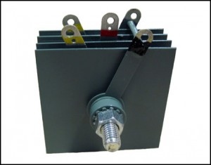

found these guys
https://cougarelectronics.com/power-conversion-components/selenium-rectifier-suppressor/
the dual diode i believe is selenium, tho i may be wrong.. it had this to say tho, so i thought it may be relevent:
SELENIUM POWER RECTIFIERS
A selenium rectifier is an electronic component that permits free passage of electric current in one direction, but almost completely blocks the flow of current in the opposite direction. Like a silicon diode, when an alternating current is applied to a selenium rectifier in series with the load, half of the AC cycle is blocked and the load receives a pulsating direct current. by using two or more rectifiers in an appropriate center tap or bridge circuit, both halves of the AC cycle may be rectified !
Main parameters :
    Voltages: Standard Voltages per cell up to 36 v rms. The voltage rating is determined by the number of cells in series
    Current: Ratings are determined by the size of the cell, the number of cells in parallel, the circuit configuration and the type of cooling, Current Ratings of 0.5 amps for a 1.0 X 1.0 cell in a half wave configuration to 270 amps for a 8.0 X 16.0 cell in a 6 phase circuit.
    Circuits:Half wave, Doublers. Center Taps, Full Wave Bridges single and three phase.
this is the thing i found in my junk drawer
https://www.ebay.com/itm/IR-Selenium-Dual-Diode-DD05-repl-GE-K118J966-1-NIP/264197276052?hash=item3d83628194:g:etcAAOSw9GhYao2F
Slava Ukraini!
~Jack Darr
Quotehahahah,
so, in fitting with  everything else, one more example of why the hell would they bother using dual diodes if they coulda just stuck a simple diode in its place?
I'm serious - really!  We should learn from our past and not ask why about anything on that unit.
QuoteSELENIUM POWER RECTIFIERS
I've played with a *lot* of selenium rectifiers in my time.
I seriously doubt that device is selenium.   The part number you quoted doesn't look too far off a General Electric (GE) Silicon Rectifier.    I tried to find a GE datasheet with more complete info, which included that device, but I couldn't find much.
The selenium rectifier normally look like the link you posted,
https://duckduckgo.com/?q=selenium+rectifier&iax=images&ia=images
- open construction as opposed to moulded.
- made from plates (round, square, rectangular) stacked side by side
- a rod, screw, or rivet passing through the plates to hold it together
- the whole thing is usually covered in some sort of paint
- Some had 3 terminals (full-wave) and some had 5 (bridge)
- A very common thing was the outside terminal had to be linked together, like this,
https://www.cehco.com/wp-content/uploads/2015/01/K362B4EC1_SR7-300x235.jpg
(Some smaller ones folded the terminals together across the device.)
- Common ones were about 1"x1" (maybe 2A) but you could easily get 4"x4".
  The smallest one I've seen was about 3/16" in diameter inside an analog meter.
  (Those little ones need to be fed a lot of electrons before they grow into the full size ones.)

Quotei had a whole box full of them ones. i was just thinking se cuz i saw some being advertised as se, and it seems like the description's kinda in line.
I'm sure at some point in the 60's GE produced a document which explained all their rectifiers and part numbers.
I saw a few possible books and catalogs for sale but no PDF's.   No guarantee those books and catalogs cover the part in the Ovation.
The sheet I posted comes out of a GE book but it's not a databook so it only contains short form info.
It's amazing how difficult it is to find data on old stuff some times, it quite literally has fallen of the planet.
