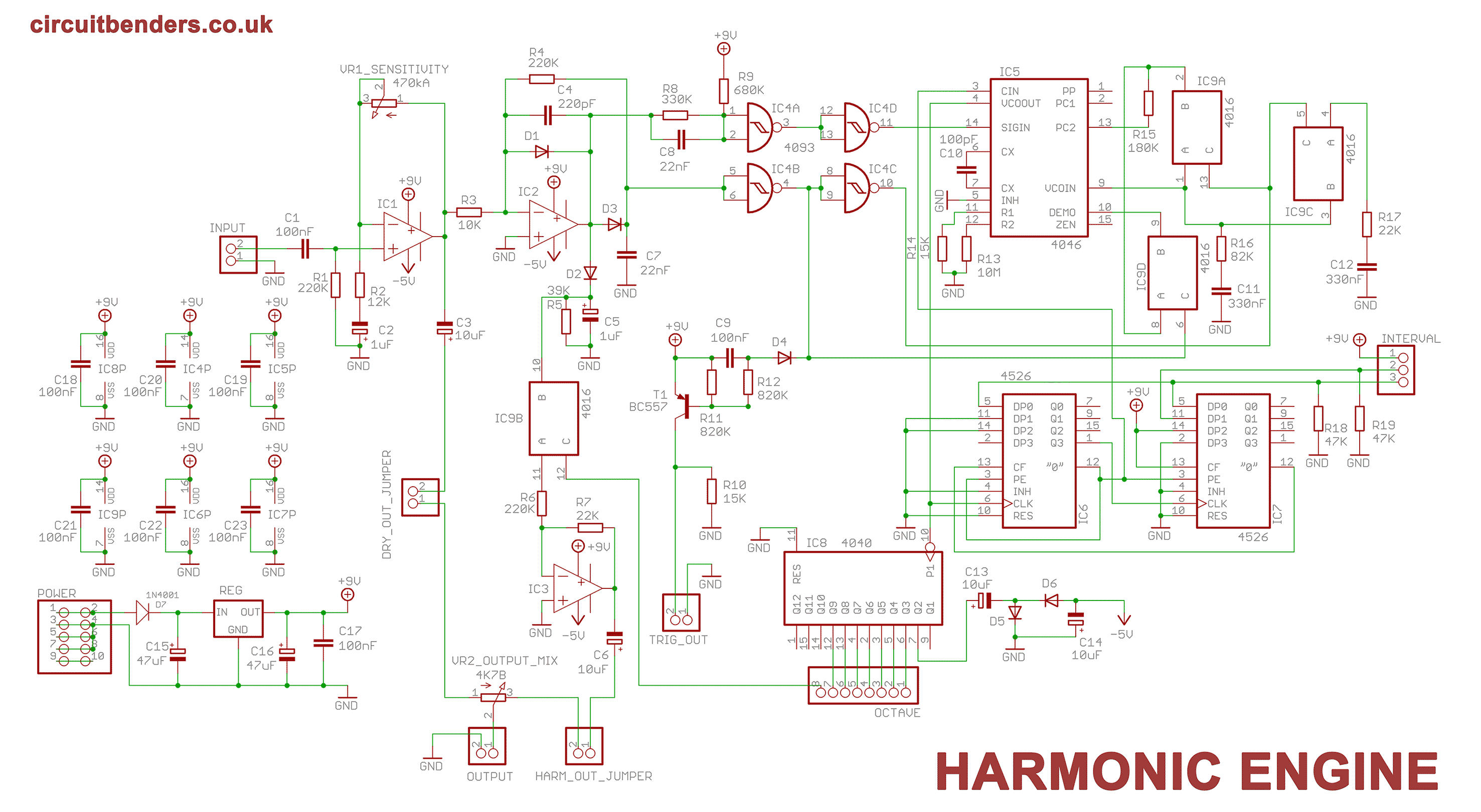

so a while ago, i stumbled upon this:
https://www.circuitbenders.co.uk/forsale/harmonic/harmonic.html
i'm a glutton for punishment, so i bought one for shits n grins
here's the schematic
so i ordered it and all the parts, took a while to track down the 4526 chips, but i got a few of them.

all it does is produce a "g" note. it doesn't track any other notes input, the output is just a g. the switch for 3rd/none/5th doesn't work either, tho you can hear it change something.
a quick voltage check last nite showed expected voltages just about everywhere, but 2 pins that shouldn't be connected on one of the chips are showing a similar voltage... i checked for shorts between ic pins, but found nothing at all.

anotherjim
A lot depends on the envelope detector IC2. One way, it controls the level of the generated harmony out of the switch chip IC9b pin 11.
The other thing, and maybe most relevant it does, is the digital control signals out of IC4 b & c control the pitch tracking. IC5 is the clever bit.
IC5 compares the Signal in (pin14) with the counter outputs back into pin3. CIN = comparator input! This isn't an analogue voltage comparator, it compares the timing of the square wave edges between Sigin and Cin or the relative phase of one versus the other. Any difference in those edges and it briefly switches pin13 PC2 either high or low. If there is no difference, pin13 is disconnected because it's happy.
That control out of PC2 controls the VCO frequency. It has to set a DC voltage to pin9 that controls the VCO frequency. You can think of PC2 as a "nudge" button. If the comparator thinks the VCO is too slow compared to the signal, it will give pin13 a positive nudge to speed it up. If it goes too fast the nudge is negative to slow the VCO down.
Those nudges are too on/off and jittery, so an RC filter is used to smooth the changes PC2 has to make. The RC filter here is in 2 parts. R16/C11 and R17/C12.
To catch and track the note of the guitar, the 3 switches in IC9a need to be working. Those switches should let PC2 control the voltage on the RC filters and get to the VCO control when the envelope picks up the note. When the note starts to fall off, the switches let the RC filters remember and supply the VCO control voltage while the note fades too low to track anymore.
So, you need to make sure the "C" inputs of the 4016 switches are being switched 9v or 0v when you play into it. If the VCO in IC5 doesn't change pitch it probably means it's at its minimum pitch (set by the resistor on pin12) and not getting nudges through from pin13.

anotherjim
Maybe it's only leakage you are hearing anyway. That Octave switch has a lot of digital signal on its wires. The Harmony generator part never shuts up.
The "VCA", if you can call it that, is IC9b. If you have 0v on pin10, it should be silent out of pin11. The harmony signal on pin12 should probably always be there and a DMM could read that as about half of 9v. Fast logic chip square waves tend to average in the DMM to about half the chip supply.
I would be tempted to simplify for now. Replace the Octave switch with a wire link for one selection, say between switch pin 1 and 8.
When you play in, the voltage at IC9 pin10 should go above 0v. How high it goes determines how loud the harmony will be out of the pin12. You have to get this envelope control thing going, or you will never get it to shut up when you stop playing.
