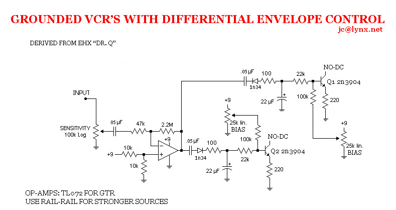

Eb7+9
Pink, just a rough idea ...
of course, you'll want to set the bias for Q1 higher and Q2 lower
I'm curious if this does anything useful
~jcm

Eb7+9
Thanks for checking Rob,
after a handful of blunders ... maybe this will be ok
previous version only went from common mid-point to extremes
I've never mucked with bipolar devices wired as VCRs
but I do remember buying a Dr Q sometime around '77 and digging it
~jcm

Eb7+9
Jim, I updated to idea and there's only one op-amp now ...
you could use one half TL072 for this side-chain
which is hovering around mid-rail, so no need for rail-rail
any op-amp should do
and perhaps use the other half of a dual op-amp as an output buffer
to the signal path
or not ...
