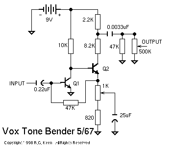

Here is the current status of what I've hacked together (my "question areas" are boxed in red):

R5: THIS SEEMS TO BE THE ONLY WAY TO GET A GOOD SOUND OUT OF THIS CIRCUIT
There's no equivalent to this resistor in any other schematic I've seen... but if you jumper it and go straight from the Q2 emitter to ground via R8 and C2, the pedal sounds... starved. Like the battery is nearly dead or something. The fact that R5 is even there is a happy accident, a breadboarding vestige from experiments getting a fuzz control to sound good in this part of the circuit. If any of you have any thoughts, please let me know!

D1: The other diode is built-in to Q2, as the PN junction between the base and collector. Do you have any germanium diodes? They would turn-on at a lower voltage than the one in the transistor, and might make a difference (or might screw-up the biasing, I'm not sure... easier to try it than think about it IMHO. Either way, you won't let any magic smoke out).
R5: It's essentially the same as having a FF-style pot that's not *quite* turned all the way up. It's possible that the thing is oscillating without it, or maybe it just doesn't sound any good at full blast.
Although not exactly the same, the Vox Tonebender and Joe Bonamassa FF have an 'extra' resistor at Q2E:
http://www.geofex.com/article_folders/fuzzface/fftech4.gif
https://tinyurl.com/r9tk3g6
If it sounds starved the bias is probably off. Most people tweak the bias with a different value resistor or trimpot at Q2C but you did it at Q2E.
You could remove the 330r and tweak the 10k to get rid of the starved sound.
