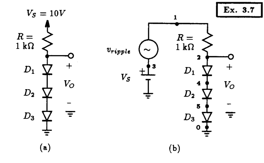

From what I can see the original design really does need hFE = 100 to 125 devices to bias properly.  If you use BC108's and they have a hFE of 200 then it's not going to work as intended.   Because of this it is inevitable you will need to adjust the collector resistor on Q1 and Q2.
Option 1:   Simplest change.   Make a 1.5V diode regulator and power the whole circuit from that.
Use circuit (a) to make 1.8V from 9V.  Perhaps use 4.7k instead of 1k.  You  might need to add 10uF to 100uF across the diodes.
The voltage across the diode is 1.8V and acts like a battery.
Option 2:  Aim preserve original clipping of first stage but increase output.
Power the first stage using the diode regulator.  That means putting the diode regulator between R4 and R6.
Next make the following changes:
- *Add* 220k from base of Q2 to ground
- Change R4 to 2.2MEG
- Change R5 to 10k.
These changes preserve a number of features of the second stage.   Good enough?  maybe maybe not.
If necessary adjust R5 or R4 to get 4.5 to 6V on the collector of Q2.
Because the transistor gain might not be 100 to 125 be prepared to adjust R3 to get a good sound over the range of the trimpot.

Thanks for all the helpful feedback! I didn't know that it was so easy to set up a voltage regulator using diodes, but it does make a lot of sense. I assume mixing germanium and silicon diodes won't be an issue here? One 1N4001 in series with a high-reading 1N34A should be the ticket for something close enough to 1.5v. Hopefully I'll get time to put one together for evaluation later today. If it does indeed have enough juice at 1.5v I wont bother making a true 9v version. This also opens up a whole new world of low voltage fuzz builds  :icon_biggrin:
I'll add a 250k pot wired as a series resistance before C3 (much like the gain control of a MKIII Tonebender) to see if it's any useful in taming the gain without sacrificing it's stock sound. Checking my inventory, I found that I do have some BC107As in the 120 range that should work out well here. Thinking about it, I also have some ge trannies in the 140+ range that I havent found a suitable application for. Wouldn't hurt to try them out here as it's not too hard to turn this into a positive ground affair ;)

I did the voltage regulator using the schematic posted by Rob Strand. The first one using a 1k resistor in series with a 5k trimpot and three 1N4148s to ground. Also added a 47u cap over them for filtering. It gave an output of about 1.7v with the trimpot cranked, so I removed the third diode which left me with an output voltage of about 1.4v with the trimpot at zero. I figured that would be closer to a real life battery situation so I went for that one. I didn't notice any difference between the two in how the fuzz performed.
