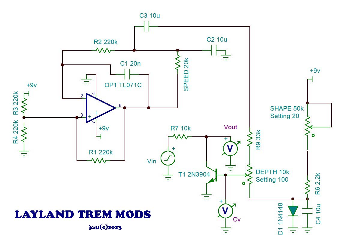

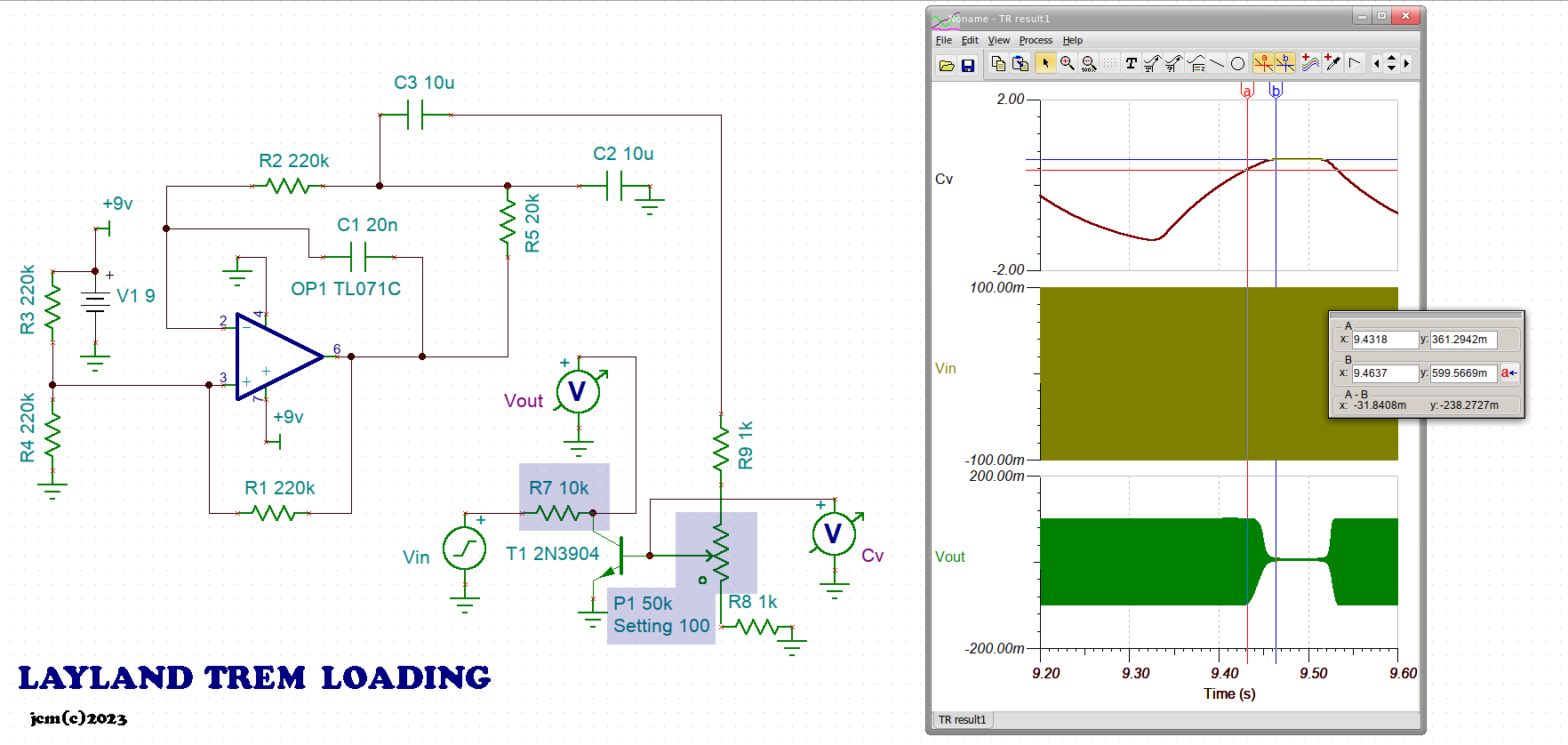

I think the loading on the Cv side is too low in the OP schematic ...
case in point, notice the op-amp isn't driving that side-chain node directly - but rather thru the SPEED control resistance
for one, an overly low output loading produces a squarish Cv voltage to the base of the bipolar transistor
it also prevents sufficient signal swing from forming there as well
... at least according to TINA, which i don't think is wrong here
notice also, as Rob pointed out, my inclusion of an input 10k resistor to form a voltage divider,
similar to how the Arbiter Trem-Face does it ...
https://viva-analog.com/dallas-arbiter-trem-face-rare-re-build/
this change allows for the potential of a more rounded TREM response
as opposed to that of a hard clamp ...
now, if instead we reduced this loading by increasing the side-chain resistance to around 50k (versus 5k or so as posted) two things happen:
the Cv swing increases to the point where we get (full trem) "choppy" action,
and the Cv waveform is now more triangular, what we would expect it to be in an a passive square-to-RC-expo-triangle conversion
http://www.lynx.net/~jc/LAYLAND-TREM-50k-MOD-linear-range.png
the question, can this passive bipolar-clamper do a little better ?!
the above simulation shows that the TREM action is pseudo linear in a very narroaw range of Cv voltages
which is just around where the bipolar transistor turn-on voltage (just below 600mV dc)
as is, I don't see the circuit doing more than a bumpy chop ...
if we could "stick" the BASE inside that range and modulate it, we might be able to get a two-sided TREM response
and this is indeed what I'm seeing if we introduce a back-bias on the 50k DEPTH pot
a simple way to do this is by biasing a grounded bipolar diode thru a (variable) resistor,
and maybe adding a fat cap to help improve AC grounding
http://www.lynx.net/~jc/LAYLAND-TREM-MODS-JCM2023.jpg
of course, the main drawback here is that when the DEPTH control is lowered so will the AC gain of the straight signal
since the back-bias provides an attenuating effect when Cv has zero AC component ...
therefore, this is not meant as a completely flexible improvement ... but rather a partial one
(ie., better shaped trem at strong settings)
btw, the back-bias can be made variable (with a rough range of 520mV to 670mV DC)
and thus playing with the resultant offset derived SHAPE becomes somewhat of a possibility as well
just some ideas to play with ...
