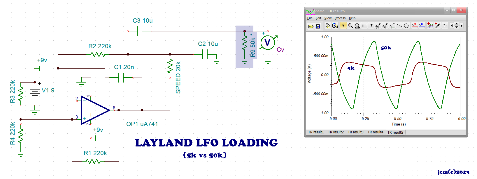

so, to recap we can look at the LFO side of things alone first ... the bipolar transistor can be ignored
namely how the resistance level on the outside (you could call it a load I guess) affects the voltage waveform appearing there
www.lynx.net/~jc/uA741-LAYLAND-LFO-LOADING.png
here we can see that loaded by 5k we get a choppy output waveform that is not strong enough to turn on the transistor later when we put it back in ... conversely, a 50k output load permits a waveform that almost makes it to one full volt - beyond what we need to turn on a bipolar transistor - hence the idea of sticking a pot in that circuit later
to be clear again, I'm lumping all resistors in the side circuit (including pot) into one total load resistor and seeing how the total affects the output ... all resistors in that branch form a voltage divider, thus scaling what's available at the top end
I do appreciate you are showing a revised version of the circuit that presumably can vary the LFO from square to triangle, and get a deeper, more choppy tremolo effect (those would both be cool). I think I would need to build this as a separate circuit; the vero of the current one is looking very battered and I'm worried it will disintegrate if I desolder anything else! If I drew a vero layout of how I interpret your schematic would you be able to see if that looks plausible and then I could try to build it? If I could add in a switch to cut high frequencies like I have on the above circuit then that would be cool (presumably that would go between R7 and the transistor?). I don't mind if I can't add the fuzz, that's for my son - he likes louder effects than me - if I get that working on the original circuit then he can have that one! Regarding your schematic, I have a few questions to make sure I understand it.
just be careful not to expect too much from this circuit ... as it is (stock) it's potentially a pretty choppy trem I would say

but let's see what you think ... I'm just guessing thru a circuit simulator named TINA

in the case of this circuit, I'm defining the Cv  as the Control Voltage seen at the Base terminal of the bipolar transistor relative to ground
sorry, shoulda been more clear
btw, I mention it so you all can understand the time plots a little better // ie., see where the threshold needs to be broached

what's the DC voltage at the base of the DEPTH pot ?
moid
Measured at the Base of the Transistor it is 0V :( so that sounds problematic! It's always possible that the issue is my layout or the breadboard itself - I only have two breadboards and the other one is full of an LED / LDR circuit that I'm working on, so the one I'm using is old and I'm not sure how well it works.

And here's a schematic for you. I had to substitute a 22nF cap for your 20nF (and the TL072 for the TL071). I was a bit unsure about the line that connects the base of the transistor to ground (you called it CV?) so I just connected a cable from there to ground; maybe that is the issue? Thanks!
Mushrooms in Shampoo -  Amidst the Ox Eyes - our new album!
https://mushroomsinshampoo.bandcamp.com/album/amidst-the-ox-eyes
Eb7+9
you're almost there mold ...
the speed pot needs to be rewired slightly and you need to remove the short at the Cv node
(a volt meter is placed at the Cv node in my TINA schematic in order to produce a waveform output in a real-time simulation)
and, btw - just in case - 20k was the simulation value I chose // use the original 10k speed pot value here ... or, maybe try 25k

so should I check for voltage or resistance on that line? And I should see a rising / falling value?
at this point you would need a scope looking at the transistor base terminal to tell anything for sure
If you want to spend another 1/2 hr on this
measure your 220k resistors to make sure, try other caps, double check power pins on op-amp...
good luck

forgot to say one thing here ...
after setting the DEPTH to 100% you'd then be hunting around with the SHAPE (diode bias) pot ...
depending on the type of taper you're using you might get lucky in a very narrow range of adjust-ability
that's assuming the oscillator is doing its thing
