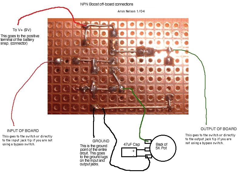

Ok guys i am a pre pre pre newb. :oops:  I have no clue what all those symblos and everything mean on the schematics and i was wondering if sum1 could give me a good site to learn how to read them. Also on Aron's boost pedal it shows how to make the circut board but nothing else. How do u connect the wires and everything??? Also how many knobs does that boost have??? arghhh im so frustrated i dont understand this at all. How would u put the led in??? How do u hook the on off switch up??? im sorry for asking all these questions but i cant find any answers. how do u connect hte wires to all the thing on the circut board???

Would it be easier to buy the tweak-o kit or do aron's project??? The only thing i dont get about aron's project is it doesnt show how to wire it.

aron
Quote from: pbsk8er03Would it be easier to buy the tweak-o kit or do aron's project??? The only thing i dont get about aron's project is it doesnt show how to wire it.
It does.
Check out these two pictures from this thread:
http://www.diystompboxes.com/sboxforum/viewtopic.php?t=941
The above picture works in conjunction with this:
http://www.diystompboxes.com/beginner/circswled.jpg
It should be noted that I do not connect the wires directly to the points from the bottom of the board. What I do is locate the next closest hole and place the wires from the TOP of the board and then bend the bare wire to touch the points. Then I solder the wire to the point and to the pad/hole that it enters the bottom of the board from.
In other words, all my wires enter the board from the top, not the bottom.
Of course you need to strip the wire first using your wire stripper, then insert the bare wire into the board from the top.
