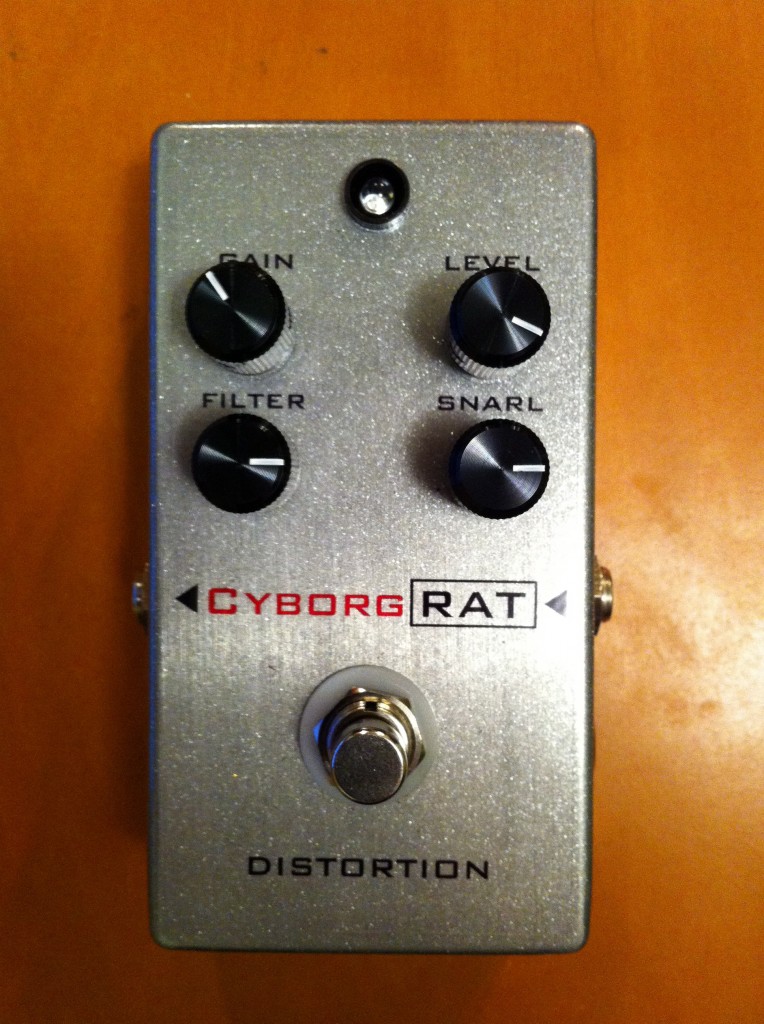

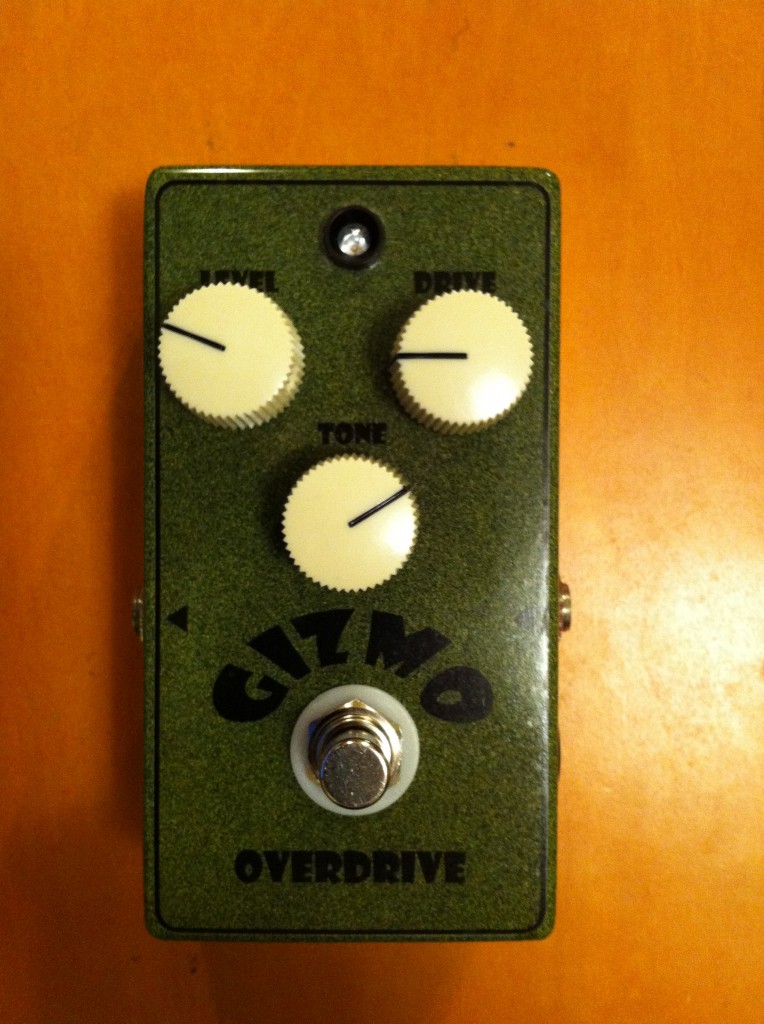

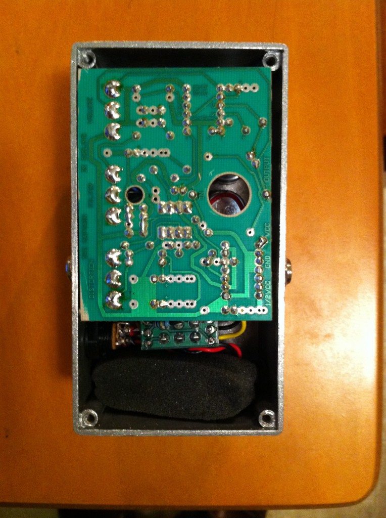

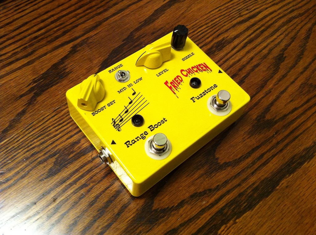

Here are a few pedals I've built or re-housed over the years.

Fried Chicken / Range Boost - Fuzz Face with bias control plus Rangemaster clone.
Gizmo - Tweaked Son of Screamer.
Cyborg Rat - Modified mid 90s Rat 2 with "snarl" knob (Reutz Mod).

Looking through the pictures here, I see a lot of you guys don't run a ground wire to the shield lug of the output jack.
And I know that you guys know more than I do.
So why is that the practice?
Barcode80
Quote from: Derringer on November 20, 2010, 10:15:10 AM
it's good practice to separate your power ground and signal ground if you can. The jacks are grounded by the enclosure, so no need to tie them to the circuit ground. In many cases, if you tie the signal and power grounds together, it can introduce noise, especially in LFO circuits (tremolos, phase, etc.).
hmmmm....
i got the idea of that, but, dont all grounds join up anyway ..whether from power or signal?..
or am i being a nooby dooby? again!. :icon_mrgreen:
i feel a slapping of my forehead moment coming on.. :icon_wink:
