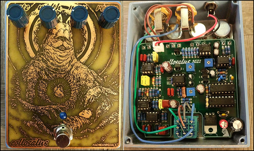

New MXR 117 layout. I did this on a 4-layer board which is now my favorite crutch for PCB design. Artwork was etched on yellowish FR-4, soaked in Aluminum Black then sanded back. It left a nice contrast on the PCB material and artwork. Finished with a couple layers of clear gloss. Sounds fantastic. My second "Gorefield" build.
