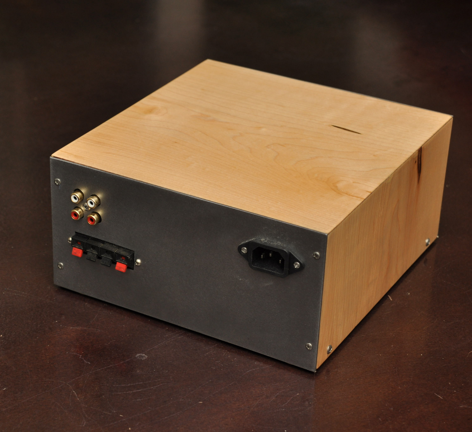

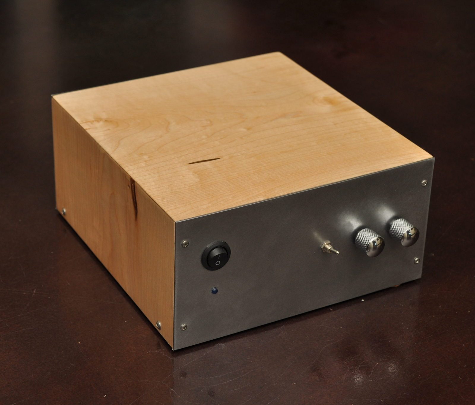

ThePracticalPeasant
"Built" a new amp for the shop; this was a bit ago, but I don't think I've posted this yet:
I'm using two of these pre-made TDA2050 boards (eBay) with with this 24V 5A power supply (eBay). I remove the LED from the power supply and the on-board potentiometers from the amplifiers and run leads to the front panel where I mount an LED of my choice along with beefier pots. A DPDT toggle switch used as an input selector, I recycled the speaker terminals from a blown boom-box, but like the power and RCA jacks, they're available for next to nothing online.
In the end, the project is really just an activity in making a pleasant looking enclosure. This one is a scrap of maple for the top and sides, cut-offs of some 11ga sheet make the front and back, and the bottom is a piece of Baltic birch plywood. Gave the whole thing a couple heavy coats of lacquer and glued some leather rounds to the bottom to act as feet.
I haven't done any testing to determine how much power these little boards are putting out, but I have this one driving a pair of speakers I salvaged from an old Sony mini-system, and it fills my 300 square foot shop long before I can hear any distortion. Apparently, even the knock-offs of these chips aren't garbage (YouTube)
Haven't had one of these (cheap, likely knock-off) TDA2050 boards fail yet;  I haven't even had a dud/DOA. One PSU went with a bang, but it was screwed to the wall, uncovered, at the time; I suspect grinding dust was to blame.
