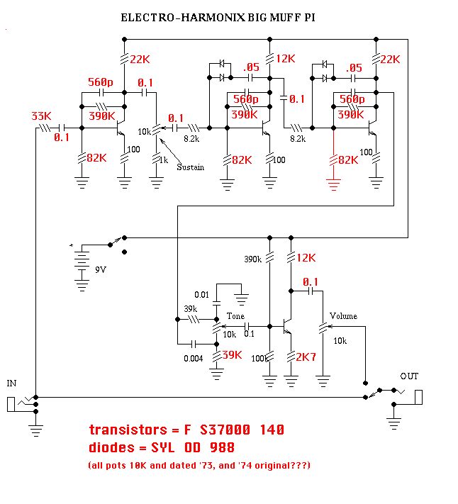

Heres a perfboard layout for the Electro-Harmonix Big Muff...i chose to do the triangle knob version, and have included some "mod" possibilities. I have yet to verify it, but i did check through it and it looks to be ok.
I'm also including the PCB version and PCB artwork, though you'll have to resize it....

gaussmarkov
nice, AC!  small suggestion just after a quick look:  how about simplifying that trace that connects Q2, D1, D2, R10, & R8?
cheers, gm

Isn't it possible to shorten the path/trace from D2 to R10?

ac,
i am guessing that you are using this schematic.  it matches up pretty well parts-wise.
i put that schematic into eagle and then tried to redo your layout in the ealge layout editor.  it keeps track of all the components and their connections from the schematic.  as long as i got the schematic right, i should be able to get your layout to work.  it's virtually as good as building the circuit to verify it.  in some ways it's better.   :icon_biggrin:
if that is the schem, then i am confident that three components are missing:  the paralell resistor (390K) and capacitor (560pF) for Q2 and the 100K resistor from the base of Q4 to GND.
best wishes, gm

gauss...youre absolutely correct...i need to make those corrections....late night layouts :)
i'll get on those asap...
till then....everyone hold off on building this.....

here's some output from my work on this.  if i have made a mistake, i apologize for leading the thread astray.  :icon_biggrin:  it happens. :icon_confused:
this is the image of the schematic that i put into eagle, based on the file i referenced above.  if i have made a mistake, it's somewhere in there.
here is my reproduction of your layout.  the confirmed parts are in solid blue.  i made some minor changes that are just style and were convenient for me.  i decided not to match up the component references just to save time and because there isn't much disagreement.
the components at the bottom are the ones that i think may be missing.  the lines show how eagle would hook them up based on the schematic.
also, i think there may be a problem aroiund my R23/your R17.  i have not hooked this up and just show where my schematic says the connections should go.  they aren't the same as the ones on your layout.  it look like you need to run a trace from the west lead of your C9 to the east lead of your R16 and then switch the connections for your R17 so that the west lead goes to ground and the east lead connects to the east lead of your C9.
like i said, i hope i have this right.   if i don't, i hope my mistakes are easy to find. :icon_biggrin:  best wishes, gm

another quickie ... i was just staring at the upper left-hand corner ...  here's a suggestion for reordering the components that you have there that simplifies things a little.  you can move some other stuff over with the space created and keep D1 and D2 spaced like D3 and D4.

Quote from: gaussmarkov on July 03, 2006, 10:38:05 AM
it looks like you need to run a trace from the west lead of your C9 to the east lead of your R16
i am pretty sure about this correction.  right now C9 is hooked up to the wrong end of R16.
a 2N5088 has a CBE pinout.  on the schem, the .004uF cap (that's C9) hooks up to the collector
of Q3.  on the latest version, C9 is hooked up to the base of Q3.  running the trace from the west
end of C9 to the east end of R16 makes it right. :icon_biggrin:
all the best, gm
Dragonfly
here's the new (and hopefully final) corrected version   thanks Gauss, for your assistance in checking this ! (we'll have to do more in the future !)
