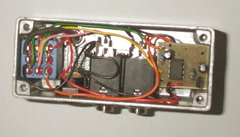

That's the insides of one of these:
Guts of a mini AB:

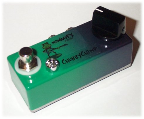

Quote from: Mr. G. on October 01, 2008, 03:15:28 PM
Here's a little boost pedal I made.
I didn't prep the enclosure between the black paint and the clear coats, so the clear coat is all wrinkled, but in person it actually looks a lot like Marshall style tolex.  So, I decided to leave it like it is.
That looks sweet, do you mind posting some more pics and maybe go into more detail of how you got that finish?

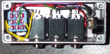

Fuzz Aldryn
Did already posted it in the picture thread but I thought this would be the right place to show off again (self-irony intended):D
guts:
