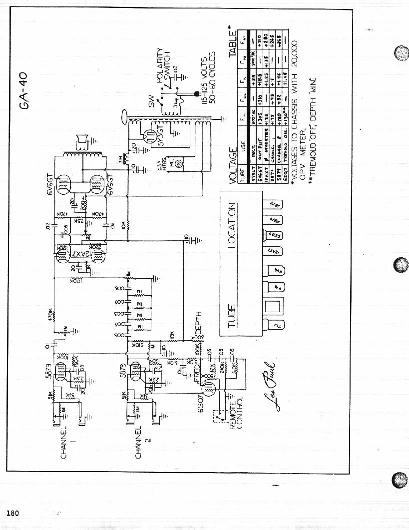

it might be possible to do a para-phase type selfspliting output stage, but I have never seen it and someone has to try to find out... ;D ( look at GibsonGA-40 for example of para-phase)
j
DON'T PANIC
Johan
DON'T PANIC

..thinking a little more about it, the paraphase might not work for a selfsplit...the tubes suck current through the OT and it might not show on the anodes as voltageswing...but I dont know...hmmm.
j
