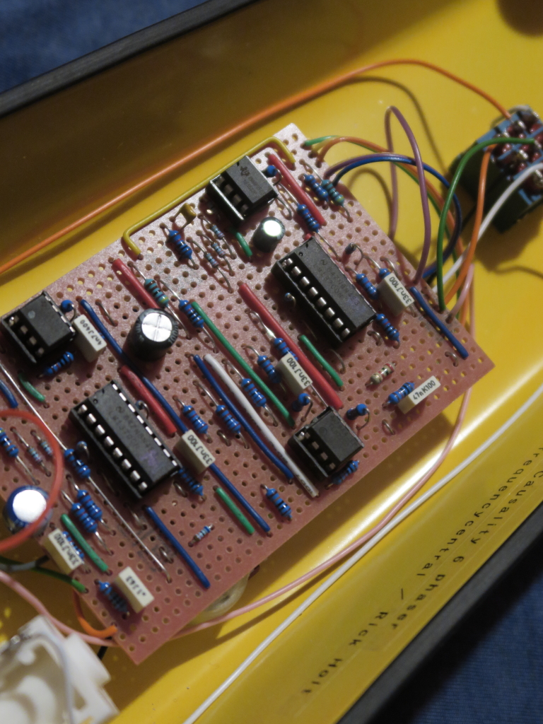

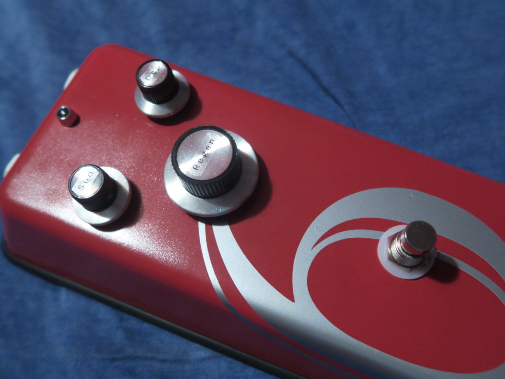

Small bump-ette to say that Rich was quite right.  I (finally) got around to building one:
     (more snaps in the main Pictures thread)
I love it Mark! Very smart. Nice to know this design is still being built. I'm just about to retire the Eurorack version, as the advent of reissue/clones of CEM3320 (Alfa AS3320) means 4 stages are possible on one chip. With a charge pump these could be used in a pedal too I suppose. Alfa are also doing a 4 OTA variant of the LM13700 (AS13704) which is ripe for some phaser action, and should run on 9V. I've been been thinking a lot about phasers again recently.....
Why use up CEM3320 clones?  Leave 'em for the synth gang.  SSM2164 clones are cheap and available.  And if a quad 13700 becomes available, so much the better.
Mike Irwin once demonstrated a phaser for me that used 2-pole allpass filter stages (most OTA-based phasers use 1-pole stages).  Interestingly, the notches were closer together than what we're familiar with.  Because of that, even without much feedback used, the sound is more "focussed" as the tighter cluster of notches moves around.
I think some sort of aperiodic sweep is desirable.  That could be from 2 unsynced LFOs being mixed, or some other variation.  Anything that removes the up-and-down-and-up-and-down monotony makes the effect something you don't mind leaving on.  Of course, there are times when you want the sweep to sync with something pertaining to the flow of a tune, so I guess the "periodic option" is still worth retaining.
