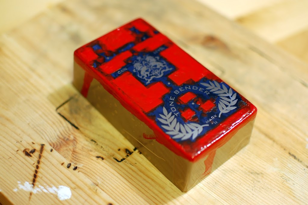

The main photo thread is getting a little crowded, so I thought it was time for a separate thread dedicated to this technique.
These are my first etched enclosures:
Loop switch
Tone Bender mark II
Please share yours!

About the decals - I can definitely relate. As far as results go, while etching is a bit of a hassle by itself, it can lead to better results, IMO.
Yes, I used Ferric Chloride. Masking is extremely important. I used Press and Peel for the graphics, then packaging tape for the sides of the enclosure and nail polish for covering everything else.
One more thing to point out - don't buy a polished enclosure for etching: http://www.diystompboxes.com/smfforum/index.php?topic=85151.0 I learned it the hard way...

Thanks. I followed MarkM's tutorial here http://www.aronnelson.com/gallery/main.php/v/MarkMs-Gallery/album24/?g2_page=1
with a couple of changes -  instead of applying black paint and then ironing the Press n' Peel, I first ironed the PnP and then used packaging tape for the sides and nail polish for sealing the top.
My masking phase looks like this:
You want to seal it off really well and fix anything that wasn't transfered right when ironing. I used a toothpick dipped in acetone for removing excess PnP in tight spots. Take your time with this and make sure the mask is ready for etching. The etching took about 20 minutes in Ferric Chloride.
Afterwards, instead of sanding off the mask, I just pealed the tape and rubbed everything off with generous amounts of acetone.
I used free black and white vector graphics so the print would come out smooth and not pixelated.
Good luck :)
