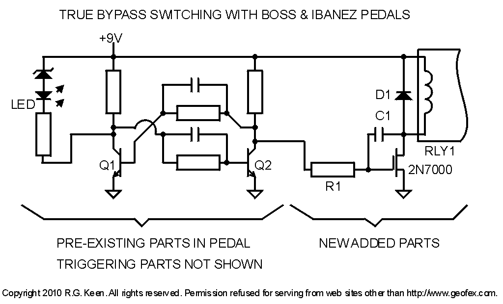

I'm curious, is it possible to use 5V relays in that circuit because I only have 5V at my disposal? Also can this circuit be modified for using 5V relays?
EDIT: Can I use 12V relays, I've found that I can buy these too?
Quote from: 323 on August 24, 2010, 05:09:57 AM
You don't need to modify it if you have enough current gain in the driver transistors to pull the higher current that 5V relays need. You could also sub in to-92 MOSFETs for the bipolars and have that work.
Yes.
Breadboard and get the circuit working to your satisfaction **first** before you go buy a lot of parts. It may need tuning depending on the relays.

Please excuse me if this question is stupid but how are we supposed to assign values to R1, C1 and D1 on the schematic for the true bypass using relays? (http://www.geofex.com/FX_images/relay%20true%20bypass%20with%20Boss-Ibanez.gif)
Mind you, this is coming from an economist, not an electrical engineer.
Is there some theory that I should read to be able to assign the aforementioned values? Are those values the same in every case?
Quote from: Fael on September 06, 2010, 10:47:43 PM
Sorry - use any silicon diode for D1. A 1N4148 or 1N914 is a common type, and works fine. You can also use any of the 1N4000 series, from 1N4002 through 1N4007.
For R1 and C1, you can start with 10K and 0.1uF. Really, you could put in 1K for R1 and leave C1 out and it would probably work OK. R1 and C1 are "slow down" parts, to make the MOSFET switch more slowly than the flipflop which drives. This helps in putting a slower voltage edge on the relay coil, and usually cuts down any clicking sounds which the coil may couple into the audio path. This varies from relay to relay; some are really bad, and some need almost no slowdown at all.
I guess the "theory" for that is to start with R1=0 and C1=0 and increase the R*C product until it quits making a [clik] when it switches - if it ever does.
It's not a stupid question, and there is some theory. But no, you couldn't be expected to know it already, it's not the same in every case. But it's also not hugely critical.

I would intend to try this schem, using two BS170 instead of BJT. But I would have some doubts:
1. With  MOSFETs is preferable to use very fast diodes (i.e. BAT41) or there is no difference, in practice, compared to 1N 4148/914 (or 1N4007)? And even choosing the best possible type of diodes, in this applications the life expectancy of the mosfet could be less than a more "rough" BJT?
3. R.G. mentioned the possibility of removing the slow down capacitors and increasing  the 10K resistors, because of the gate-source capacitance in  MOSFETs. But what is great in this capacitance? I read in the BS170 datasheet (Fairchild): "input capacitance," output capacitance" and "reverse transfer capacitance", which confuses me.  ???
Quote from: nexion777 on November 24, 2010, 01:24:25 AM
In this circuit, it makes no difference. The diode is there to "catch" the relay coil, not the MOSFET. The catching diode needs to be very fast in power supply circuits which operate at high frequencies. In this circuit, it gets operated maybe once every couple of minutes, so it is not critical.
QuoteAnd even choosing the best possible type of diodes, in this applications the life expectancy of the mosfet could be less than a more "rough" BJT?
If it's done properly, the life expectancy of both BJT and MOSFET are the same - far, far longer than the relay. The only place where a MOSFET is more fragile than a similar-power-rated BJT is if there are transients on the gate that puncture the gate oxide. This can be prevented by adding a protection zener of about 12V with its cathode to the gate and anode to the source of the MOSFET. MOSFETs are actually more durable than BJTs in some cases because they have no second breakdown mechanism.
Quote3. R.G. mentioned the possibility of removing the slow down capacitors and increasing  the 10K resistors, because of the gate-source capacitance in  MOSFETs. But what is great in this capacitance?
Just that it's already there, and you don't need to add another part.
QuoteI read in the BS170 datasheet (Fairchild): "input capacitance," output capacitance" and "reverse transfer capacitance", which confuses me.  ???
Input capacitance is the capacitance from gate to source, and is a simple capacitance. Reverse transfer capacitance is the capacitance from drain to gate which gets multiplied by the voltage gain or transient operation of the device. Reverse transfer capacitance appears to be much bigger than the actual number. Reverse Transfer Capacitance is like the capacitor I showed from collector to base, but it's built in inside the device.
Both bipolars and MOSFETs - and JFETs, tubes, everything that amplifies - have both of these capacitances, and they need to be understood for fast operations. Using a much larger capacitor makes the variation of the internal capacitor not matter.

I finally breadboarded the relay driver by R.G. using a 4069 hex inverter, a 5V latching relay  and a couple of BS170. Power is supplied by a 78L05 regulator. Well, the driver work, changing the state of relay.  :D
BUT... haem... There's a problem: measuring the voltage on the 10K resistors, I read 5V when a coil is engaged and 0V when disengaged. I suppose that is bad, the circuit should supply the needed voltage to activate a coil just for a little amount of time, right? Here the voltage is the same after 10 minutes ( :icon_exclaim:) in fact the regulator has become noticeably warm. I tried to connect the 100K resistors to ground instead of +V, and although the circuit still seem to operate, now the readings on the 10K resistors alwais show me 5V (engaging or disengaging the coils have no effects now)....
Quote from: nexion777 on December 12, 2010, 09:16:12 PM
OK. Time for debug.
Measure the output pins of the two inverters which drive the ends of the two 10Ks. These two pins should sit near ground all the time, except when the switch is flipping states. If this is not true, if either one ever stays high. then look at the two input pins of the inverter. These must be pulled up to the power supply by the 100K resistors. They cannot be pulled down by the front part of the circuit if the two 0.1uF capacitors are inserted in the circuit properly.
Get out the DMM.
nexion777
In fact was a my (stupid) mistake: 100K resistors were connected in the wrong way...  :icon_redface:
I have now corrected the error and the circuit works perfectly... true, the half of the  coin in diy is... the debug!
As alwais... thanks R.G. !
Quote from: nexion777 on December 12, 2010, 11:32:48 PM
You're welcome. I know that mistake well - I've made it several times myself.  :icon_biggrin:

Sorry to drag up an old thread; but can someone explain what the MOSFET is actually used for in this relay switching?
It looks like it's used to slow down the relay so as to not 'click' as loud...is that correct?
Jim Rodgers
jim@americanhc.com
Quote from: jimosity on July 28, 2012, 05:15:20 PM
It is the power element that switches the tens of milliamperes which are needed by the relay coil to work. That is its primary job. The other stuff is to slow the MOSFET down from the 100nS or so it would switch on its own to a few milliseconds to prevent the sudden voltage change on its drain from coupling through the parasitic capacitances into the audio path.
The CMOS stuff can't run that much current all on its own reliably.
