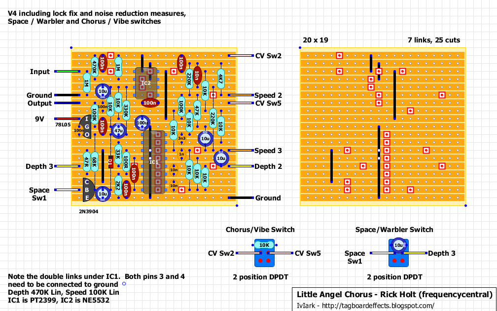

Hi there, I did Google search and found this interesting picture
I tried to build one but no modulation at all. Please advice :)
