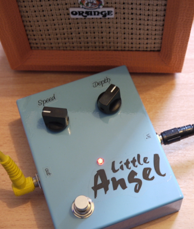

Hello Guys,
I have a little problem with the little angel chorus I bought from Chris(Elmusicoloco). The thing is that when I use the chorus in the fx loop of my new bought Ibanez TSA15H amp, the chorus seems to give a noticeable volume boost. I think the volume boost is there when not in the fx loop, but it is much less noticeable. Is there anyone else that has noticed this problem?
And the most important question (for me), is there a way to fix it? Asked chris, but he is to busy with business right now, and I don't have the patience.
Hope someone can help me out here.
Thanks,
Tim

Without hacking into the PCB, voltage divider on the output. Maybe use a 100k trimmer and set it just how you like it.

Set up a 100K trimmer pot in a voltage divider format to set the output to unity.
Take a 100K trimmer and connect the PCB audio output to one lug. Attach the other lug to ground. And attach the wiper to the pedal output.
Adjust to taste. Set it and forget it!  ;D
Look at how the MXR Dist+ Volume is wired here and just substitute the pot for a trimmer:
