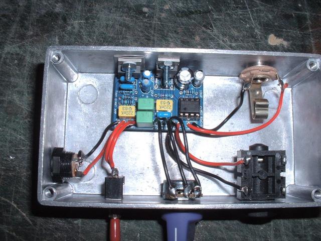

Finally boxed mine up tonight! I added a pilot light, on-off toggle and BMP tone knob. Sounds great so far! I'm just waiting to decide what to draw on the top of the box, then I'll post pics!

I'm loving this little guy! Throuth a 12" speaker it really wails. So Happy I might have to get another one (for my bandmate to use with her keys).
Here are a couple pics of my Tiny Happy Giant---I added a pilot light, BMP tone control and on/off switch (disconnects power):

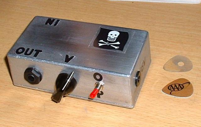

I made one for both bass and synth use (2 inputs) in a 1590B, and added a power off switch via a pot with a switch built in. Here's what it came out looking like:
We tried it out last night at rehearsal through a 1x15" bass cab, which isn't ideal for synths. It sounds pretty good! My wife (who's using the amp) uses a bass eq pedal for tone shaping, which helped dial out some of the inherent problems with the cab. The only problem I ran into is when both the synth and the bass are plugged in at the same time, there is an immediate volume drop for both. Would adding buffers to both inputs cure this?
Taylor
Quote from: space_ryerson on April 13, 2011, 01:06:29 AMWould adding buffers to both inputs cure this?
Yes, but you might also just try adding putting a resistor in series with each input:
bass in - 10k resistor - "node a"
synth in - 10k resistor - "noda a"

space_ryerson

Interesting, I'll give it a shot, and let you know how it goes. Easy enough to try the resistors before bothering putting the buffers in. Thanks!

Taylor
Cool, glad you're liking it.  :)
The resistors will do the mixing better than just connecting them directly to each other, however I suspect you'll have some volume issues, since synths are line level and passive basses are instrument level. You probably want an actual active mixer.
space_ryerson
I suspect you're right as well. For what it's worth, it's an active bass, and the last pedal in the chain is a buffered bypass (DOD Bass EQ). I'll give the resistors a shot tonight and see how it goes, and take it from there.
