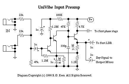

Does anybody do that? Look at Uni-Vibe:
click for more
The biasing is tricky, but Q2 Base must be at low voltage so that Q2 collector is at the 1/4 to 1/3 point that Q3 needs to work split-load. Assume Q2 base at 2V and 16V supply. 14V across 1.2M+100K is 11uA, essentially the same as the 7uA that I derived above (allowing for different assumptions about guitar resistance and device hFE).
(BUT: note that the actual plan has 22K and 47K resistors out front. Considerable level is lost, S/N is well below what-it-could-be. Showing again that a very-lowest-noise result is NOT essential in guitar work.)
10uA is a very small current to drive additional loads. As seen it works near 1Meg in the collector side, so any load must be OTOO 1Meg. UniVibe buffers this with Q2 to get 47K, then Q3 to get (split) 10K output(s).
That's a lot of circuitry, and as R.G. observes, three stages together may be stable on the matchbook simplification but unstable in real implementation with "minor" parasitics. Such 3-stage inputs are rare in guitar. 2-stage or 1-stage inputs will generally want to run the first device at some higher current.
