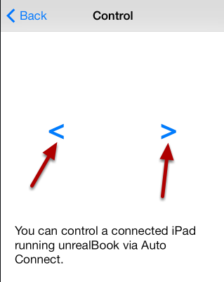

Auto Connect
Use Auto Connect to connect to an iPad running unrealBook for iPad. To do this, set Auto Connect to ON in unrealBook Mobile and in unrealBook for iPad. Set unrealBook for iPad to slave mode. Make sure they have the same network key. Once they are both connected, you can use the Control window to turn pages on the iPad or to send files unrealBook for iPad.

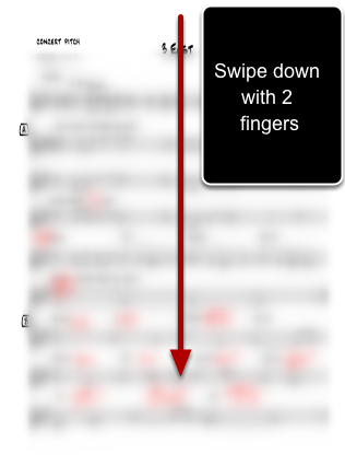

File Settings Window
You can access settings for each file from the File Settings Window.
Swipe downwards with 2 fingers when a file is displayed to access the File Settings Window
Swipe downwards with 2 fingers to access the File Settings Window.

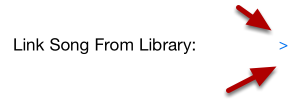

Link Song From Library
Press this to select a song to play from the iTunes library in your phone. Once a song is playing it is linked to the current displayed file. After exiting the File Settings window, you can use two fingers to tap on the page to start and stop the player. (2 finger tap)
