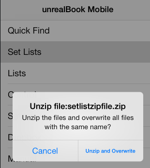

In Apple Mail, read the received email. Press on the set list file (setlistzipfile.zip) and choose Open In… Select unrealBook Mobile. An alert will appear asking you if you want to unzip the file. Choose Unzip and Overwrite. This will unzip the set list file and every file associated with the set list. This will overwrite any existing files with the same name.

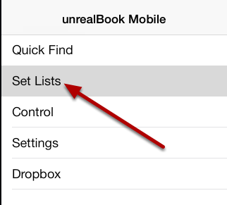

Select Set Lists

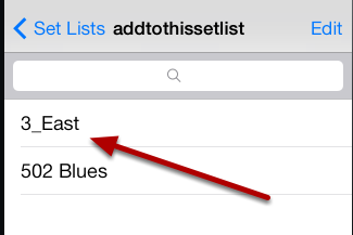

Select your received set list
Press the selected set list to view the songs within.

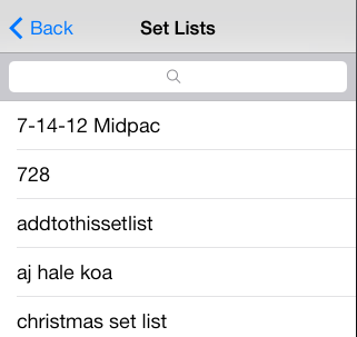

Viewing set lists
You can view your unrealBook set lists if you copy them into the unrealBook Mobile documents folder. You can also import set lists that are emailed from unrealBook for iPad.
Selecting an unrealBook set list
Press Set Lists
Press a set list to view the songs in the set list.
Pressing any of the set lists, will allow you to view the songs in the set list.
Press a song in the set list, to view
Press a song to view
