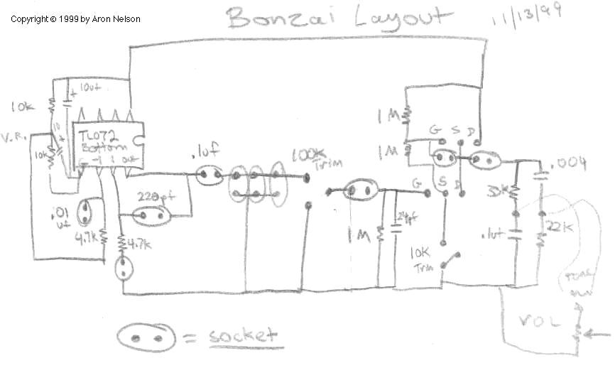

Bonzai Pedal Note, you must run a wire from the ground pin of the IC to ground on the circuit.
Build this pedal once and configure it over and over many different ways. With easy modifications, this pedal can do the following circuits:
TS- series feedback loop distortion (use the feedback loop with clipping module)
Shaka III distorter (standard config)
MXR Distortion++ (bypass the FET MiniBooster)
FET Booster (no clipping module)
Op Amp booster (just use op amp, no FET MiniBooster)
Funky Fuzz Face (op amp into Fuzz Face circuit instead of clipping diodes - include or omit MiniBooster)
How can it do all of this? Simple. By using a separate clipping module (separate perfboard with clippers or another type of distortion circuit), and sockets/jumpers, tap into this pedal at different points to create many different types of distorters. It's very powerful and easy to do. You can also tap into the pedal at the end of the MiniBooster and pass the signal to a new filter module. I've used the Rat, Bluesbreaker, Shaka 3 and Jack Orman modified tone controls in this pedal with good results.
Much more on this pedal to come....
Skill level: advanced, but you only build it once.
A configurable, flexible distorter.
