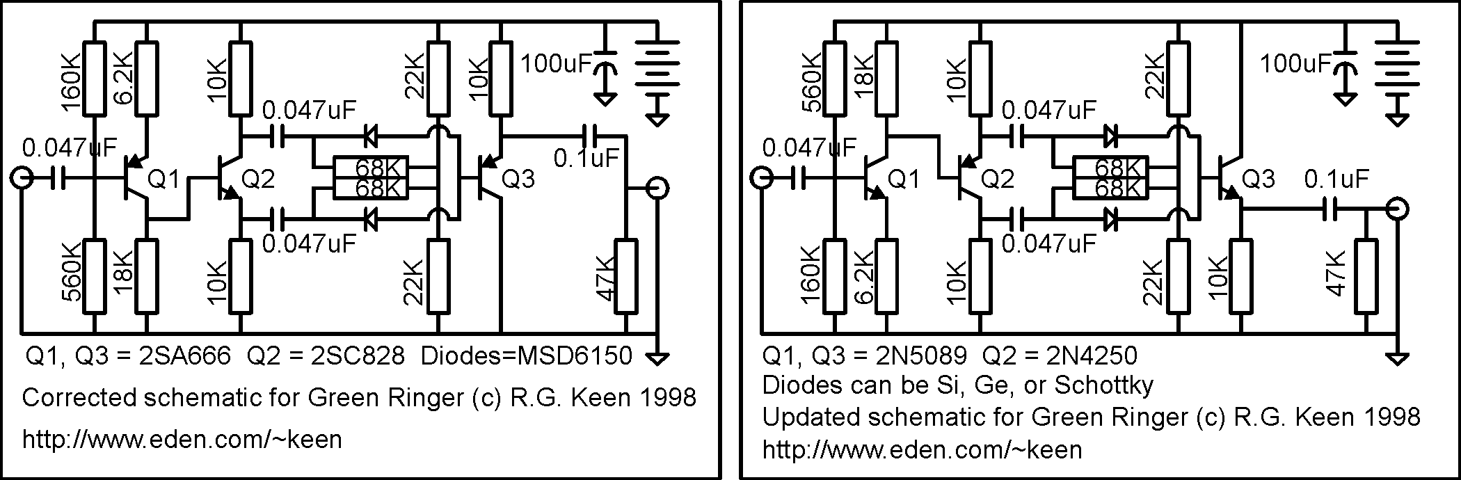

Note that not all of these schematics are guaranteed to
work. Some may be completely wrong. A good place to ask about
effects is Ampage
and alt.guitar.effects, a good newsgroup. I have added notes
in red to the schematics believed to have errors. Items
confirmed by me or others have an OK!
in green. This is not meant to discourage you from trying the
other schematics out, just that I haven't heard anything about
them.
In very general terms, I would say that probably every schematic
on Jack Orman's (AMZ) page
is fine; Keen's (GEO) page
is excellent as well. Most of Justin
Philpott's Site is excellent (he has an effects feedback page),
the one's that have verified problems have corrections noted so
pay attention to the notes.

- Hornet
- OK! a germanium/silicon transistor
hybrid Fuzz Face that screams! High gain, high sustain, ANGRY,
yet can get bluesy when your guitar pot is turned down. Minimalistic
design that can be "tuned" to perfection. Better watch
out cause the Hornet will sting The Rocket! Sound
sample available.

- 11/8/00 Small
Bear has a nice PNP version of the Hornet, check
it out!
- 7/11/99 -
- Notes: Not much to this circuit; the trimpots allow you to
really tune in and adjust the circuit. Please try the 2N388A
transistors as they are dirt cheap (18 cents when bought in lots
of 5 or more I think). The 2N5088s can be readily found through
Mouser. The rest is pretty much Radio Shack or your local store.
Convert to PNP transistors by changing the orientation
of the lone 47uF electrolytic and reversing the battery polarity.
(The battery AND 47uF cap POSITIVE to ground).
- Mods: The input cap is critical; for classic fat fuzz tones
use 2.2uF to 10uF to larger! (you may consider socketing it -
I did) The output cap is less critical; I have found that .1uF
is fine for me. The .05uF that I use I have found to be very
good because it changes the frequency response of my guitar the
least. I have around the same bass as when the unit is bypassed.
The trimpots allow you to really tune in the sound. Many shades
of distortion will come out as you fool around and turn them.
C? is a high end rolloff cap, you can put .001 to .01 to larger
values and hear what it does (socket this cap). You can also
put the usual 50K pot at the input BEFORE the input cap as described
in the Technology
of the Fuzz Face - (GEO)
Excellent article about the Fuzz Face.
- You could also make the 1K resistor off of Q2's collector
a 47K, then make the 100K trim a 47K and tap the output off of
the junction between the two. This will reduce your output level
and make it a lot tamer.
